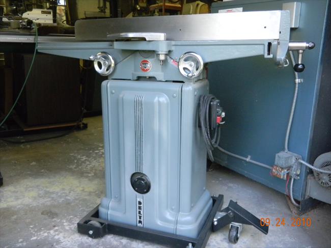

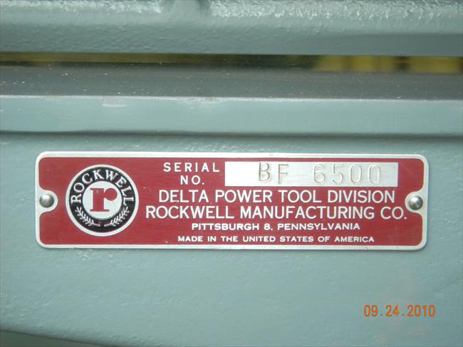

searching on CL found this delta 6" long bed jointer on the 31-852 CI base. PO had a small home wood shop. Jointer was in good condition. no before pics. did a complete tear down. all parts
placed in a engine cooker to clean and remove old paint. rusted parts were cleaned in a glass bead booth. repainted parts and order new bearings and new cutter head blades.
front view with modified mobile delta base

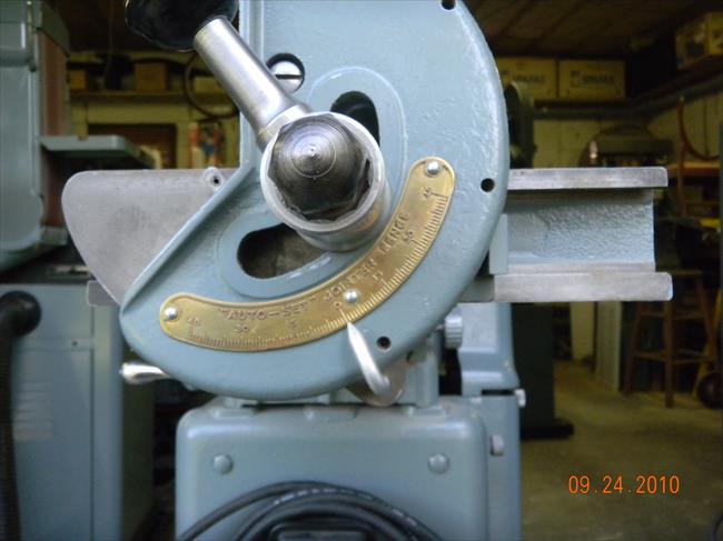

rare brass auto-set angle gauge

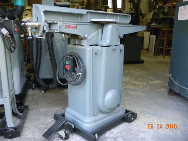

rear view showing rear guard

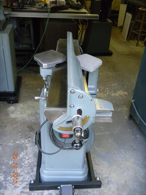

back view
