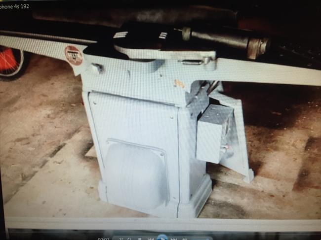

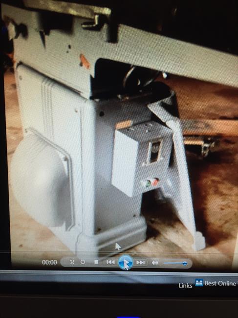

this is a delta 37-315 8' jointer that I have been looking for . Found and purchased from a fellow OWWMer in June 2013. these are the only before pics from the listing. Now in progress of restoring. was 3ph 1hp motor converting to single phase . found a delta 1 1/2 hp era correct motor. all parts placed in a engine cooker to remove old paint and rust removed in a glass bead booth. Found missing table lock knob and upper belt guard. will post pics when restoration is complete.
Comments: as found pics from listing
Comments: pics from listing
