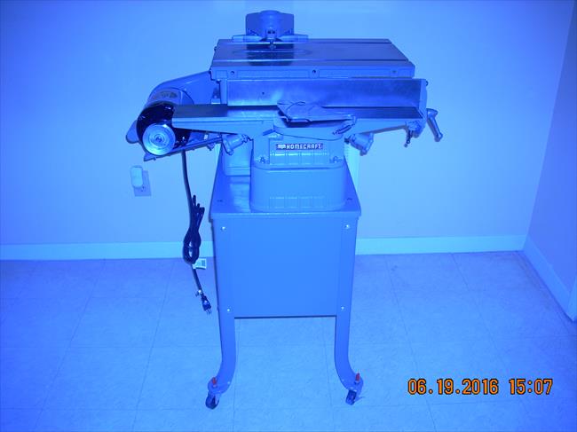

I picked this combo machine up off of Craigslist back in 2012 for $30.00. It was in pretty bad shape. Had been previously painted silver. Sanded it to bare metal welded up drill holes, and primed and painted the saw, jointer, drill and stand. Replaced the arbor bearings and the motor bearings. Restored in and out the 3/4HP 3450rpm Delta motor. This combo machine will last another 60+ years. I actually restored this saw in 2013 but just now got around to attaching/hanging the parts off it this week. Need to mount the 11-120 Drill Press. Did not come with the disk sander. 34-500 Saw arbor RPM: 4,140, 37-110 Jointer arbor RPM: 4,025
Front View
