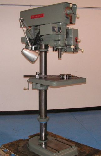

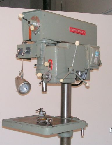

Machine Type: Drill Press
Machine Size: 20"
Submitted By: Tim Grunden
Description/Model: Powermatic Model 1200
Date of Manufacturer: ??
Last Updated 6/28/2005 9:04:37 PM
Very nice Drill Press offered on ebay with an auction end date of June 17, 2005. Seller (Charney Machine and Tool), added the following information:
SPECIFICATIONS:
Table Working Surface, W x L........... 19" x 22"
Spindle Center to Column............... 10"
Swing to Center of Circle, Maximum..... 20"
Spindle Stroke, Maximum................ 6"
Spindle Taper.......................... #3 MT
Spindle Speeds, Range.................. 200 To 2000 RPM
Throat Depth........................... 10"
Column Diameter........................ 4"
Motor, Horsepower...................... 1.5 HP
Floor Space............................ 26" x 35" x 75" H
Weight, Approximately.................. 750 LBS
POWER ................................. 220V/3 PHASE
Comments: Photos included with permission from "broadway3043" of ebay
