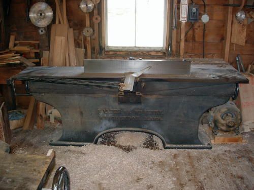

Baxter D. Whitney & Son, Inc.
Winchendon, MA
Machine Type: Jointer
Machine Size: 16" x 8'
Submitted By: Tim Kuist
Description/Model: 16" wedge bed Jointer
Date of Manufacturer: 1910's ish
Last Updated 7/3/2005 12:18:35 PM
This machine was originally in the pattern shop of the Baxter Whitney factory. After the company was sold in 1955, the machine was bought at auction and moved a mile or so to a cabinet shop in Winchendon, where it resided for the last fifty years.
Very heavy and beautifully constructed, it's also quite unusual - for the dozens of Whitney planers, table saws, shapers and other Whitney machines I've seen, I've never seen another jointer.
Said the previous owner - "well, they didn't make many of 'em.."
The machine has babbit bearings and a squashed marshmallow two knife head -- not a true square head, but one that was turned and looks like it was run through a double surfacer, creating the flats onto which the slotted knives were bolted. Nice, because it will act like a round head in that it won't allow the large chunks to be removed that a square head would.
Oh, and after fifty years of use, the previous owner still had all ten fingers....
My total cost - $258.18, including fuel for the truck, and lunch...not bad.
Will post more photos as I reassemble it in my shop.
Comments: The big fella before the move...
