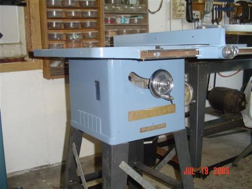

I had posted some photos of my Homecraft ts here before I restored it. These are the almost-finished photos of the ts now. Just need to get the labels painted just right, somehow. Maybe someone have an idea. Also, I need to know if there was a label denoting the model number. When I was going through the restoration, I noticed the raise and angle handles have set screw holes on them. The part manual didn't show any. I figured I should put allen set screws in them and I did. I believe they were planned to take up any excessive end plays on the two shafts. At least I got the sloppy endplay out of the raise shaft. I also found out that I need to realign the trunnion assembly parallel to the miter gauge slots.
The front view shows how the labels had faded from cherry red to rusty brown. Anyone has any idea on how to restore the color?
My Sony dsc-p52
Front top view. Table top scrubbed clean and waxed with carnuba. I would like to know what kind of white plastic I could use on the fence. Any idea?
My Sony dsc-p52
Right rear view showing the original-type Homecraft motor.
