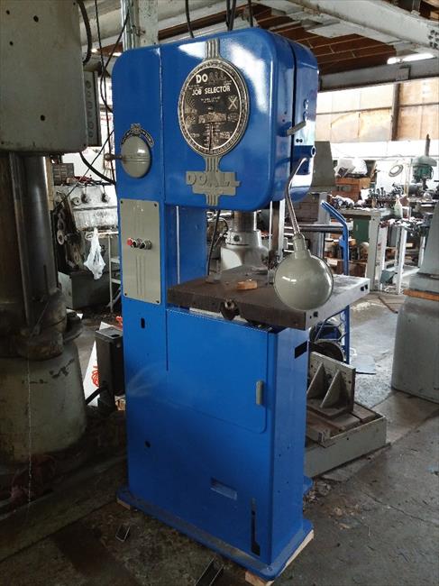

Acquired from a local manufacturer, who surplused it when the transmission failed.
Transmission and Reeves drive replaced with worm drive and VFD,
Frame, sheet metal, and badges striped and repainted
mechanical parts cleaned and replaced as needed
Non-functional butt welder replaced with control panel
It now runs beautifully; solid, quiet and accurate
