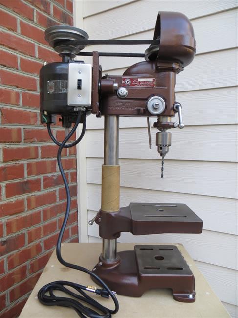

I bought this machine on Craigslist for $50. It was in rough shape, not turning well and very rusted. The motor was packed full of sawdust and very badly wired. I did a complete restoration including opening the motor and cleaning it out and re-wiring with 14/3 wire and a switch. I was even able to re-build the chuck and greased all the necessary parts and oil the bare metal as I assembled. This machine runs very smooth and well and I'm excited to have it in my shop! It is also VERY heavy (estimated to be 80 lbs).
Side view with added switch and new wires
Motor cleaned and ready for assembly
