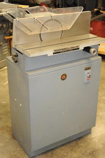

Acquired from an individual selling his whole shop. This unit required some restoration due to minor rust and all the grease being dried up. In addition the out-feed surface was out of plane from the in-feed and required alignment. This is a nice-running machine that cleaned up nicely and spins up nicely.
Uniplane, 22-300 full frontal

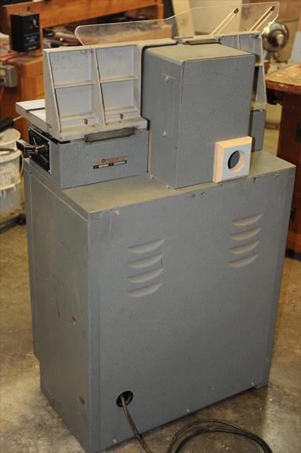

Uniplane 22-300; Backside. Dust collection is much better if the upper enclosure is outfitted with foam to preven leakage around the enclosure. This allows the vacuum to be more concentrated around the cutterhead. It also helps to reduce the belt openin

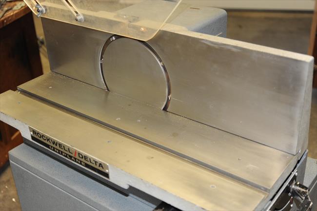

Uniplane, 22-300; Table, Fence detail

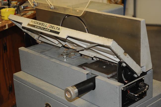

Uniplane, 22-300; Table at full tilt

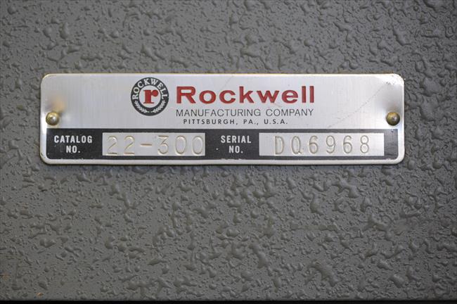

Uniplan, 22-300; Nameplate. According to an article on this site, this serial number appears to have been manufactured in 1967.

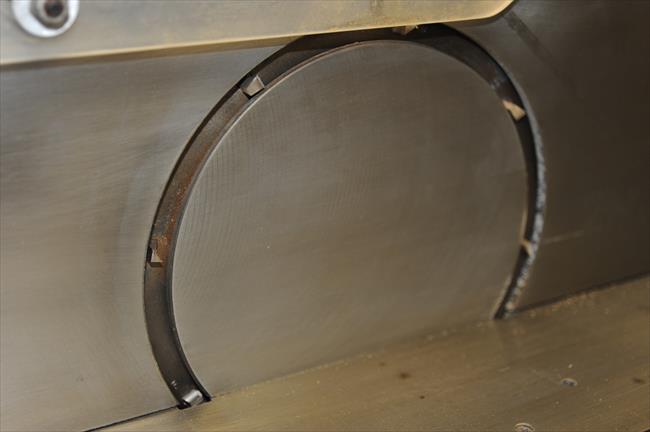

Uniplane, 22-300; Cutter head detail
