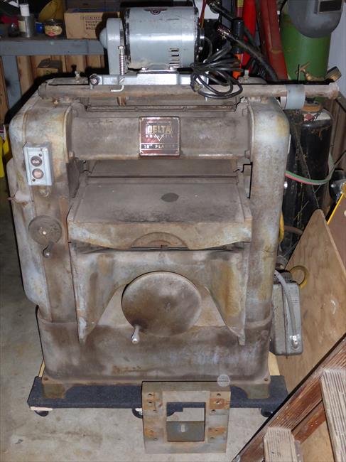

Found an add for a 13" delta planer on CL and went to look at it. It was in reasonable shape, but the owner also had a 18" planer for sale. The 18" planer came with a knife grinding attachment and an extra side casting that provided the option of mounting the 3 HP motor single phase on the other side, converting it to a belt drive. The worm gear was in excellent shape. The planer was heavily coated with LPS and there is hardly any rust on it. All placards were there. I couldn't resist and I may have overbought! It may be a while before restoration, I have to find a spot to park it first, it is quite heavy, I am guessing 800 to 1000 lbs.
Finally got around to finishing the planer. It took about 6 weeks of work at my pace. Bead blasted all the rollers then polished them up. All new bearings except two in the feed gearbox, a total of 12. Replaced most of the hardware with Stainless Steel, Some had to be made on the lathe. Found some 600W oil out of a Model A Specialty parts store in Ohio. It cost more to ship the quart of oil that the oil itself.

As Purchased
