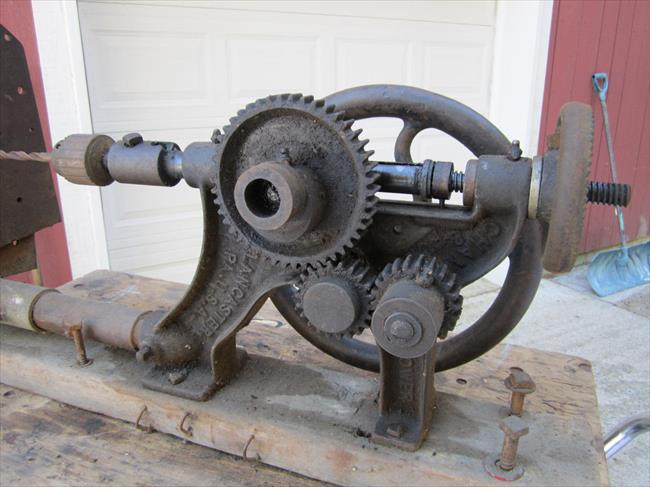

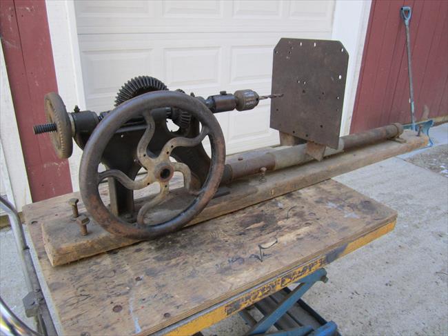

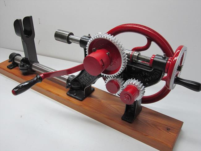

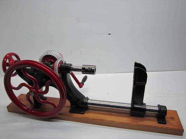

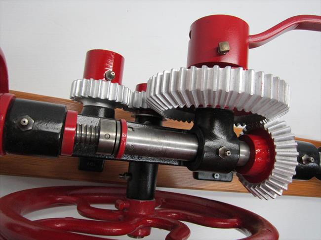

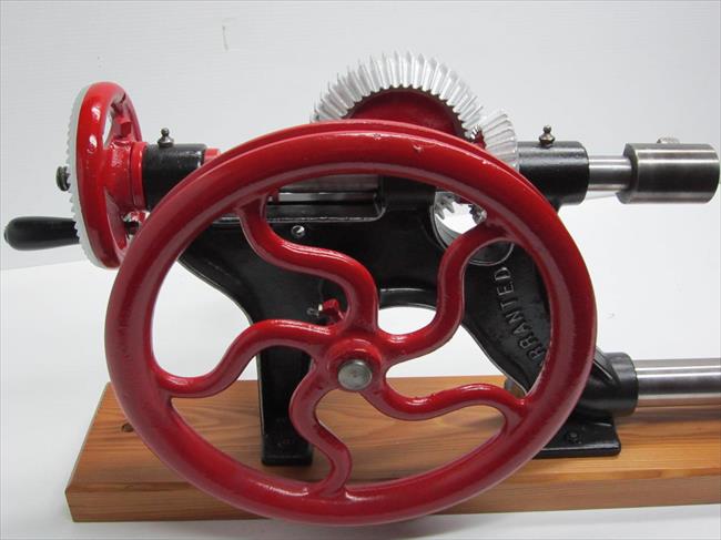

Machine Type: Drill Press
Machine Size: drill to center of 15"
Submitted By: Jacques Lagueux
Description/Model: post drill no. 95
Last Updated 8/15/2017 6:39:19 PM
Missing: crank, crank hub, column, table support, feed arm and claw. This is a two speed drill by changing the crank from one gear to the other. The flywheel is 14" dia., spindel 1- 1/8" dia. with a 3-1/2" up and down run.
