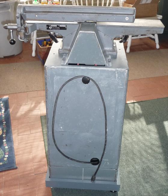

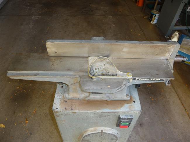

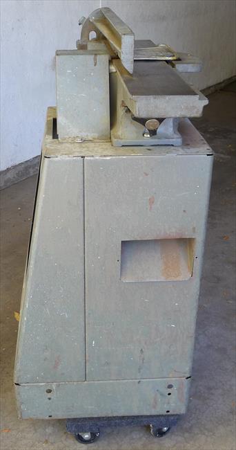

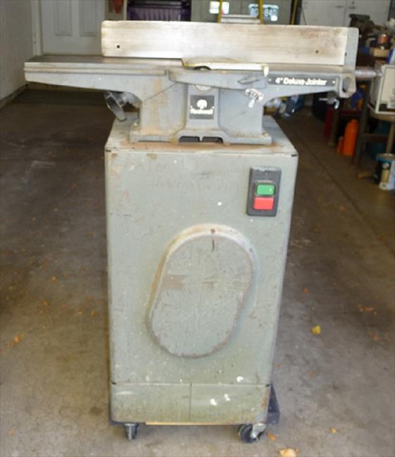

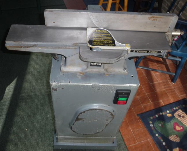

Recent CL purchase. Needs some TLC. Model 37-290 4” Jointer Deluxe with 50-121 Stand and 62-144 ½ hp motor (3450 rpm).
I removed the overspray as best as I could with Motsenbockers Lift Off #4 Spray Paint Graffiti Remover and replaced the following items:
Replaced Bearings (6202LU double sealed)
Replaced the Blades
Replaced the Fence Wrench
Replaced On/Off switch with a Powertec Switch from Home Depot
Replaced the Insulator (where the cord comes out) with a Bridgeport 9796 2" Insulated Knock Out Bushing
Replace the access door knob with one from Ace Hardware
Now it’s ready to go.
