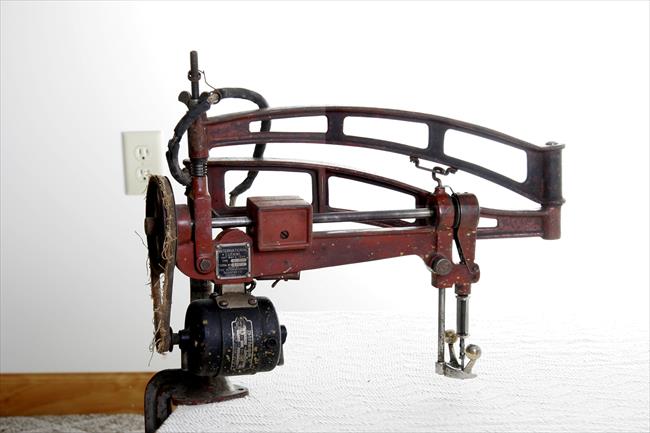

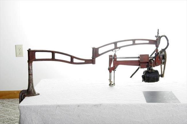

The Cutawl machine is a precision reciprocating cutter. This unit is supported by a stationary arm with cantilevering beams. The cutter rack has a counter weight to balance the swivel head to allow for a controlled projection allowing up to a 48’ cutting radius. It was used to cut materials from light fabrics, matt board, wood & soft metals for picture frames.
This tool might be the oldest of its kind.
It was liberated from a scrap pile destined for the dump back in the early 80’s. It was owned and used by a Photo/Frame shop entrepreneur located near present day University of Penn in Philadelphia, PA.
It was used to size matting, prepare oval frames and other intricate settings for pictures that were popular prior to WW2.
No restoration has been undertaken (other than cleaning) for this find because of its perceived rarity. To my knowledge it is 100% original.
I have used it to cut intricate shapes from leather. Its cut is so clean the edge of the leather does not need to be slicked. Due to the deterioration of the cord and drive belt I invested in the K11 model for current projects.
Comments: Swivel head
Source: Bill Cairnes
Comments: the base, beams & cutter rack

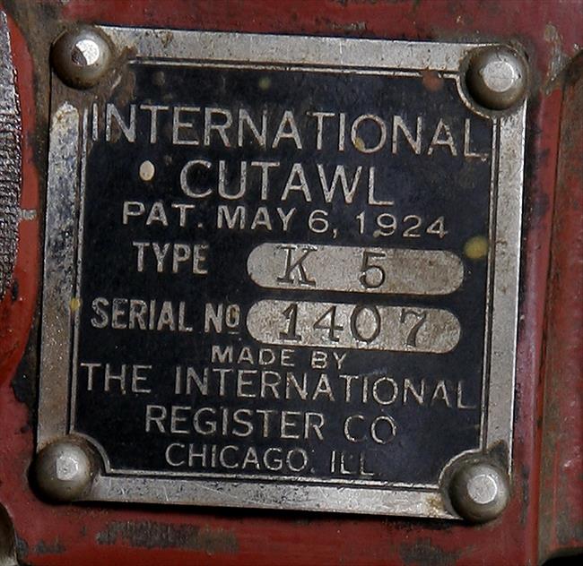

Comments: make, date, S & M

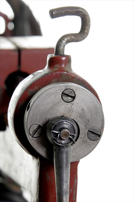

Comments: depth adjustment
