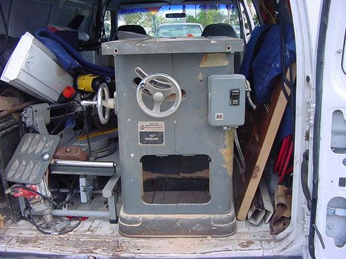

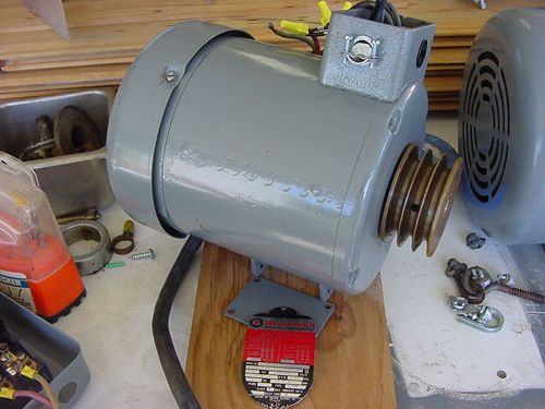

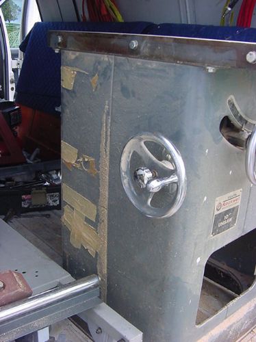

This is the Unisaw upon arrival from a friend of mine's cabinet shop where I paid 500 dollars for it. Has a 3phase motor in which the bearings were promptly replaced as the bearings in the arbor were also. I originally used cheap (competitively priced) bearings with the original arbor and the blade wobbled so I bought a new arbor and used the same type of cheap bearings; the blade still wobbled, bought a set of SKF bearings and the blade rotates extremely straight now. Sanded down all parts, primed with rustoleum red then smoke gray. Wasn't sure I wanted to buy the saw after first seeing it, so went home and typed "34-450" at google.com and came across the OWWM site, saw numerous photos of the other unisaws that had been refurbished and said, "yeah, picking me up a unisaw tomorrow!".
I will have some more photos to add when I finish.
Arrived at the house.

Side view. All of the other views are like this one. Full of sawdust.

The motor ready for installation. Need to find some pins to re-attach the motor plate. If anyone knows where some can be found, please contact me. My email has changed and been updated as of 5-21-09. Thanks.
