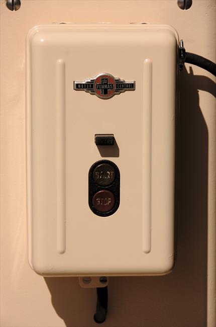

Close-up of the Furnas magnetic starter used to start the Delta 1 hp repulsion-induction motor
