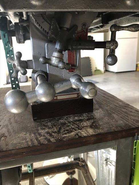

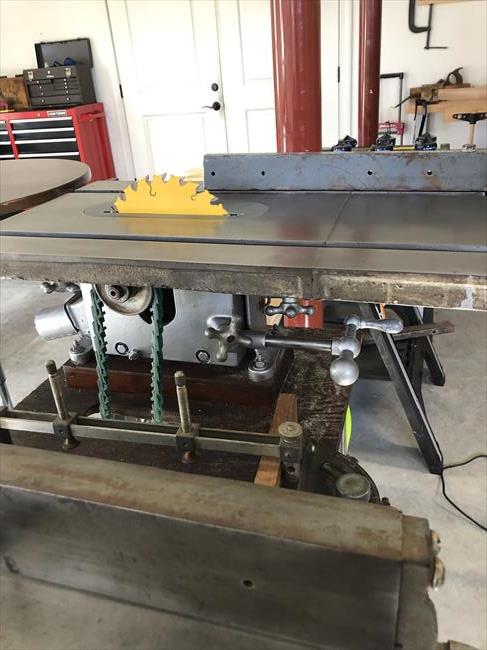

Came with a jointer from a friend who acquired it from the grandson of the original owner. The grandson replaced the arbor in the 1970s. It was left in several sheds not sealed from the weather for many years. I swapped out the bar that came with the fence for a shorter channel that I cut to size per UK standard. The original splitter could not be mounted after the grandson's changes and the table tilts instead of the saw, so I opted for the shorter fence and a feather board to the right- back of the blade to prevent kickback. I still have the original fence. I use an adjustable height table behind the saw for the outfeed.
Comments: Setup of saw

Comments: Undercarriage
