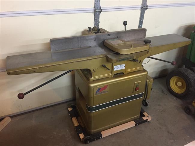

Found online. Came out of a pattern shop where it was purchased new. It was setup for 3 phase but I found a 2 hp, 1 ph motor that would fit and rewired the motor control and switch. I have also swapped out the original head with a Shelix, and put it on a mobile base.
Comments: torn apart, cleaned, readjusted and ready for work.
