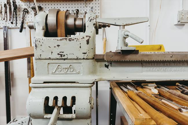

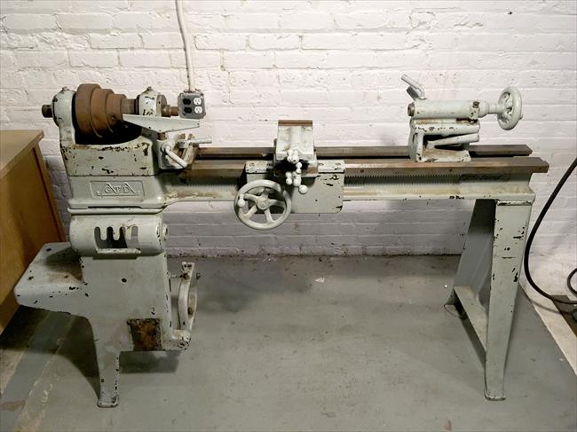

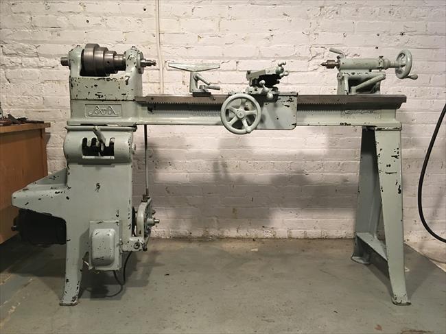

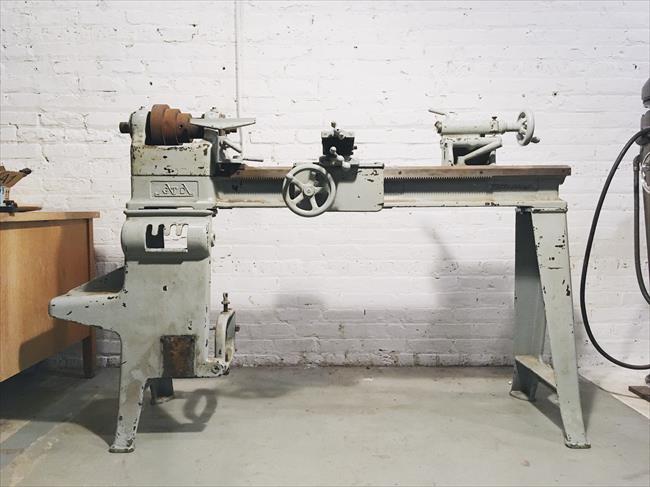

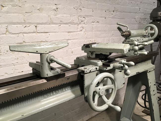

I purchased this lathe in December 2018 in Waterford, Michigan in a completely disassembled state with a decent amount of grime/surface rust. I stripped every part down (with the exception of the spindle) and cleaned/derusted each part individually leaving the paint in tact. It appears to have been originally painted black, then subsequently painted light blue.
Spindle runout measured at .0005" TIR - spindle thread is an unusual 1 3/16" - 10, bed is 5' long with 36" between centers. Westinghouse 3/4 HP 1725 RPM motor.
Comments: Cleaned/Derusted/Reassembled
