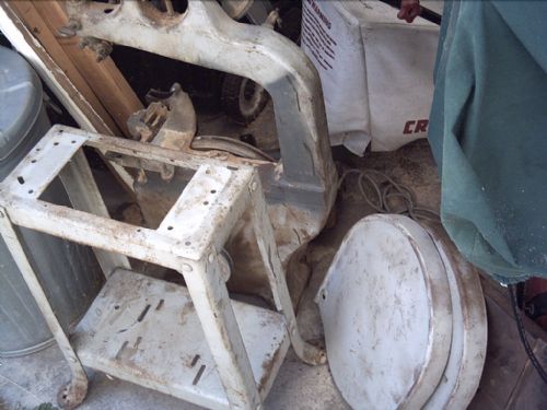

I bought this saw from a junkpile at an estate sale. The price was right. It was
stripped to bare metal and new bearings installed. It has urethane tires, ceramic
blade guides and cuts perfect. I have cut oak veneer with it with great success.
It had a very old motor that was poorly mounted. We put on a new Dayton 1hp motor.
It has a new link belt drive that is smooth as silk. It did not have a belt guard
so one was made from mdf.
Comments: This is the way I got it...
Comments: Here it is after a complete retoration and new motor.
