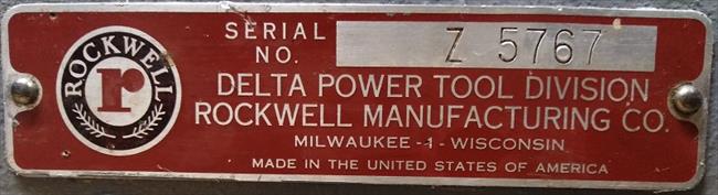

Wilhelm Strumpfer
No. 40-110 16" Homecraft Scroll Saw
circ 1952
Z 5767
1/14/2022 1:29:36 AM

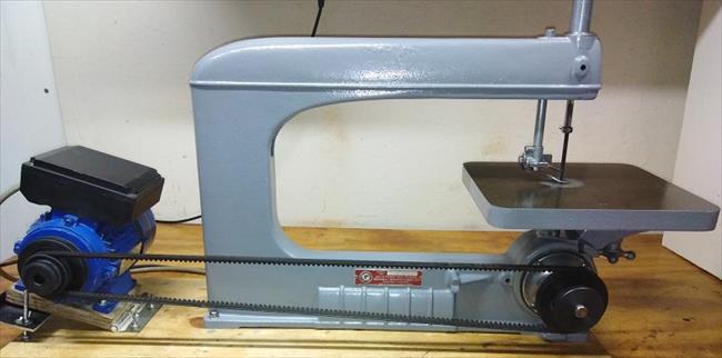

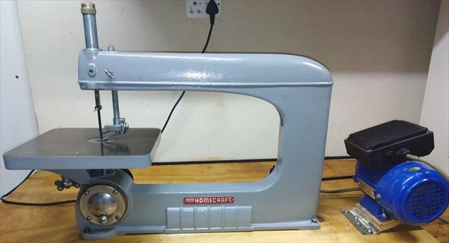

This scroll saw requires a few more restoration steps, a stand and pulley guard.
Bought this off the internet, January 2022.

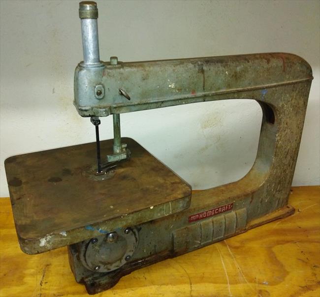

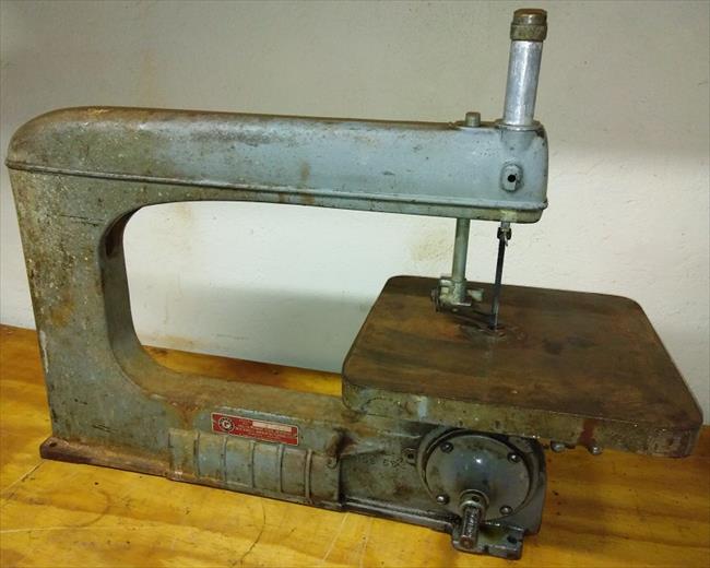

The oil sump contained mostly a thick paste, a mixture of oil and wood dust, gathered there over a lifetime. The dust seems to have entered in there through small openings in the lower blade clamp, at the top of the vertical reciprocating shaft, which is in fact a hollow tube. In the restoration I cleaned out all of this paste and plugged up the tube with a cork. I want to use the saw for light sheet metal cutting and if metal dust were to enter the sump that would of course be bad news.
I turned the pulleys out of nylon round bar which seems to be working well. A stepped pulley on the motor for speed control.
The brass bushes are still usable but will be replaced later.
The air blower tube is on my list for replacing.
Left side, after restoration
