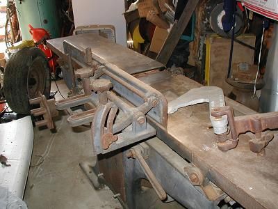

Purchased from an individual in NC who had originally bought it in IL with the intention of restoring it. He never got around to it and it sat untouched for several years. The machine was originally a direct drive but the motor had been discarded.
Comments: Jointer as purchased
Source: my camera

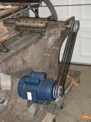

Comments: This is how it sits today. Everything has been stripped and blasted, new Babbitts poured and the motor is in place here for a test fit.
Source: my camera
