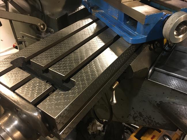

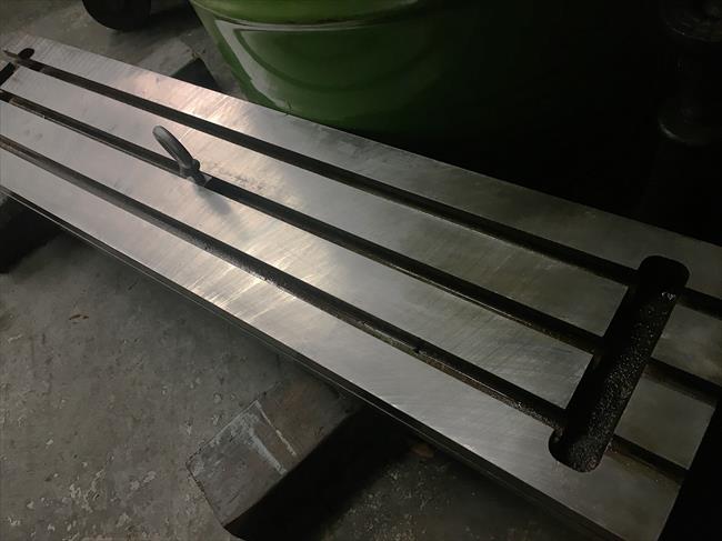

The original table had a broken-out T-slot, which appeared to be from a badly torqued T-nut. The remainder of the rear T-slot was pulled up almost .075 in places! I found a clean used table, had it ground, scraped, and flaked on the ways, and Blanchard ground and flaked on the top and sides. It is beautiful and square, but until I turcite or replace the original gib, there’s not much adjustment left in my X gib.

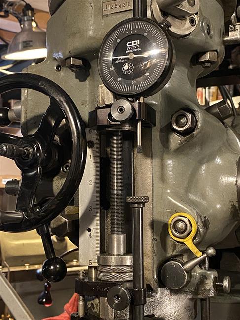

One of my favorite additions is the DeePOL Quill travel indicator.

Comments: Front of the J Head showing the DeePOL quill travel indicator and quill lock retainer.

Comments: Replacement table after Blanchard grind and before flaking and truing.

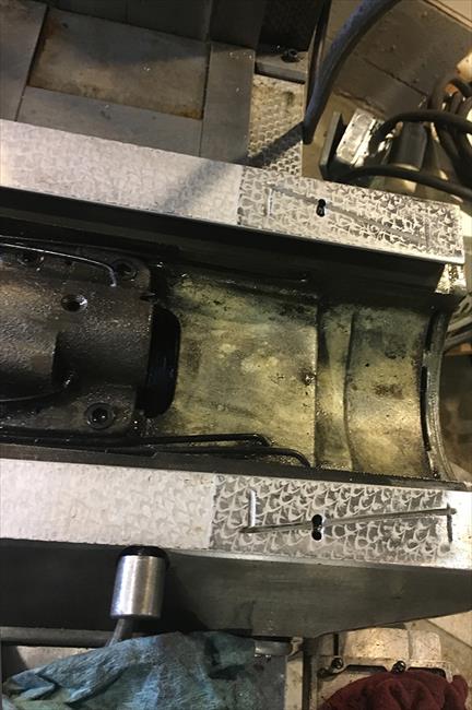

Comments: Even if I wasn’t replacing the table, it would have still been SO important to remove the table and clean out the saddle and all the oil passages! SO glunked up with crap, and possibly grease! Ugh! This was a real mess when I opened it all up. The kne

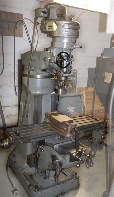

Comments: The machine as found at the dealer. Shows the bad T-slot, and original vise which I sold and replaced with a Kurt.
