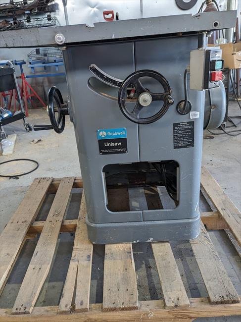

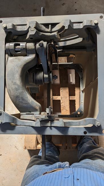

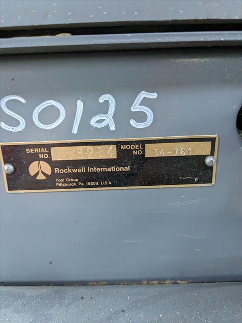

This saw was purchased in November 2023 in an online school auction from Keller,Texas ISD. The miter guage was included but no fence or blade guard. When I went to pick it up they brought out an Incra Ultra 72" rail and Ultra Jig fence assy and said this is part of that lot number.I said are you sure as it was not in the one and only picture from the auction site. When they said "yes", I just said Thank you very much! Nobody bidding on this saw knew about the Incra rail and fence or the price and interest level would have been higher. In my research on this site I found that the model number 34-761 corresponds to a 1.5hp single phase unit. This saw had to have been modified as it has a 3 phase 230/460 control box with OL protection,a Rockwell 3 hp 3 ph motor and control ??? It should have been a 34-764.
I really was bidding hard on a Powermatic 180 and PM 31 sander. Nobody was seriously paying any attention to this Unisaw, as a Beat up Weanie saw was drawing all the attention(the Saw Stop went for $1600). I ended up spending $350 plus tax on this Uni.
It is a 3hp 3phase and after attaching a vfd, it fired up and ran pretty strong and quiet. Lucky always rules the day!!

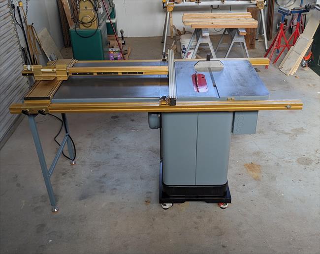

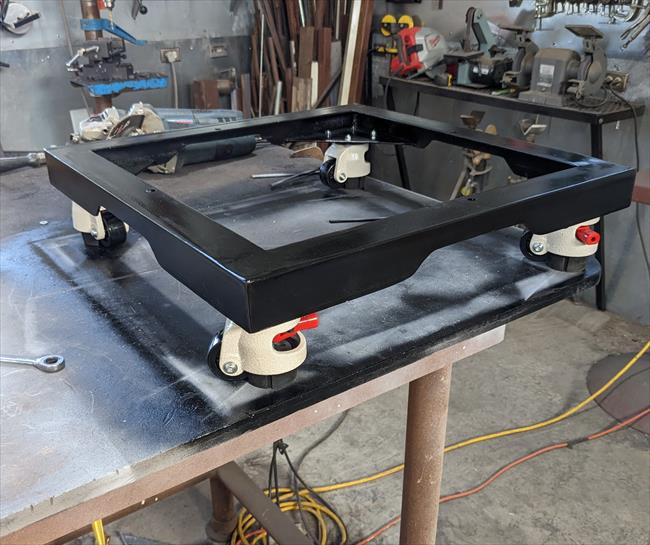

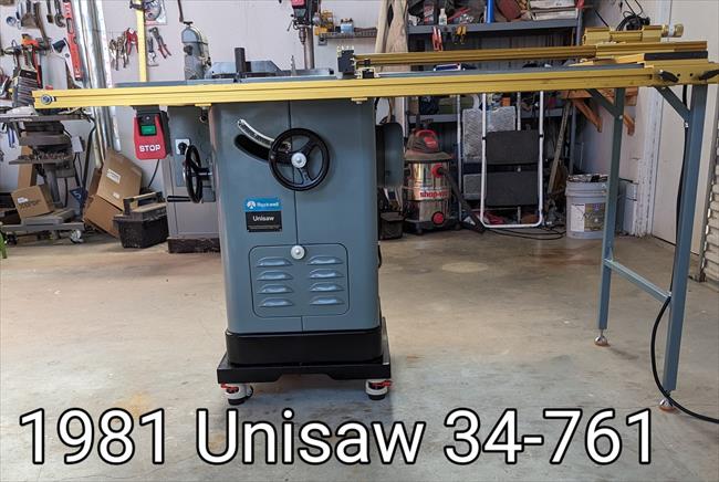

Update 01/07/2024 Finish rebuild and ready to go to work. Replaced arbor bearings and belts, motor bearings, install VFD, VFD power switch, on off paddle switch on left side, weld in 14 ga steel patches on holes from old controls, used dust door, new old stock usa made throat plate, made extension table out of 11 ga steel, replaced damaged incra parts (TY High school student), made a new base with retractable wheels, and refinish with SW DTM alkyd semi gloss. Passed nickel test from start up to shut down.
Unisaw after rebuild and nickel test
My Google Pixel 6a Camera
Rear view after rebuild with steel extension table
Unisaw in my shop after 3 hour road trip.
Model and serial no plate
New mobile base with leveling retractable casters. With the slanted cut outs I tried to bring back the original Unisaw design features.
