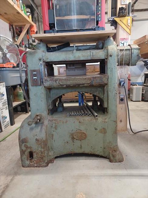

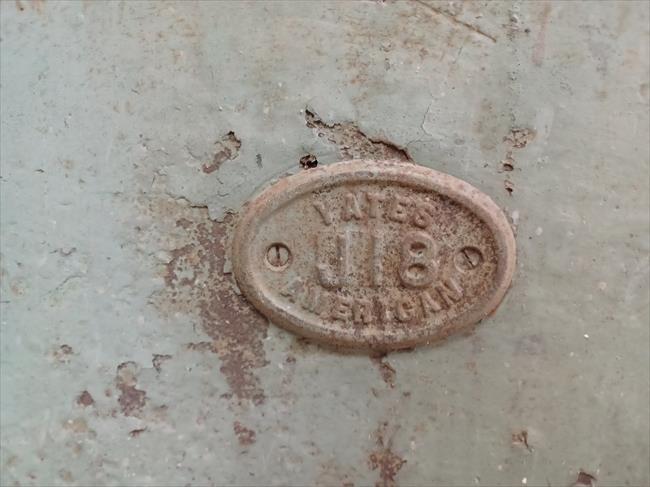

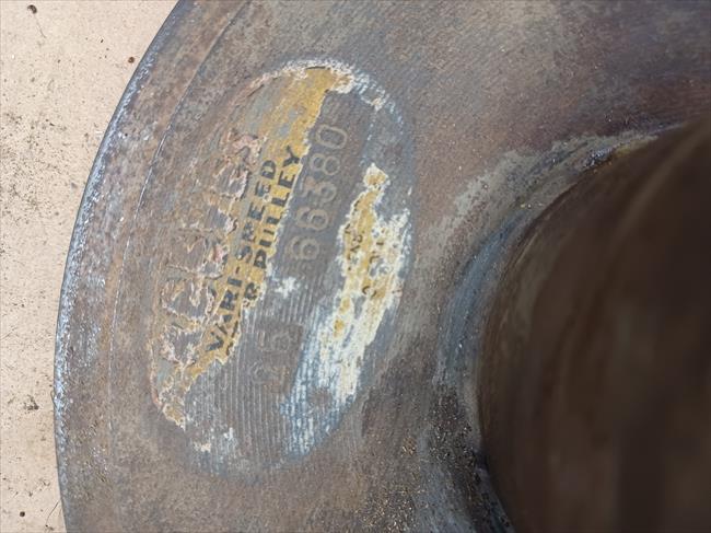

This machine was acquired from a defunct cabinet shop in Cape Girardeau, MO. After many measurements and a few math equations I've determined that this machine uses a 1922V507 Cogged V-Belt for Variable Speed Pulleys that measures 50.7" x 1-3/16" x 13/32" for the Reeves Drive system. The leather drive belt has been substituted with a Gates K080816 Serpentine Belt that measures 1-3/32" x 82-1/8". See updated photos below.
BEFORE-Picture of planer front.
Anthony M. Sowell
AFTER-Picture of planer front.
Anthony M. Sowell

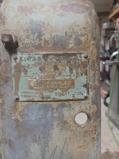

Series Number Plate
Anthony M. Sowell

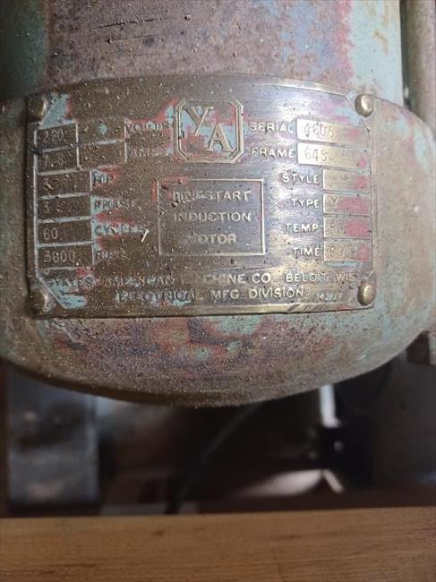

Motor Specification Plate
Anthony M. Sowell

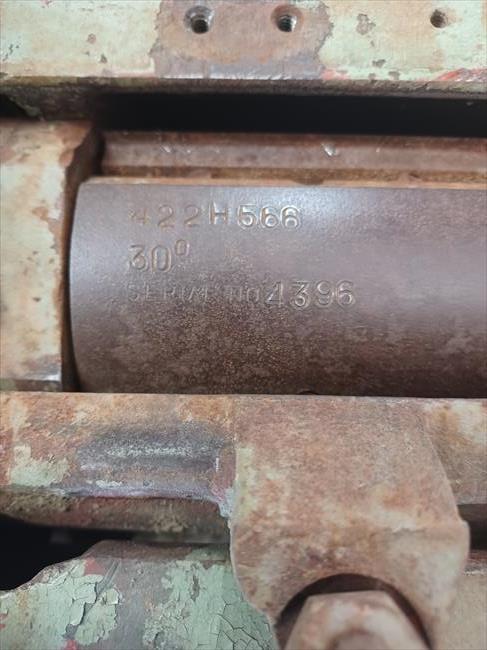

Information stamped into cutter head.
Anthony M. Sowell
Reeves Drive Pulley Tag
Anthony M. Sowell
