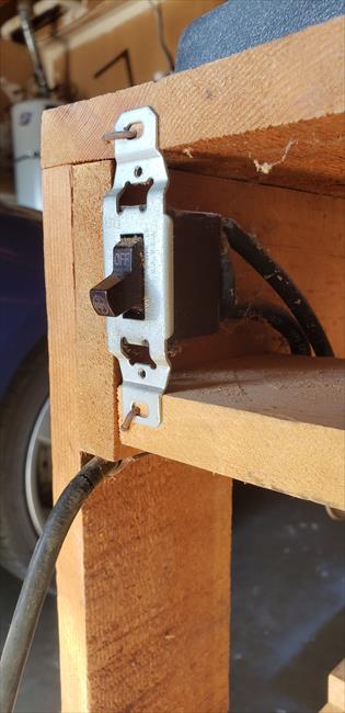

Original switch, with no box

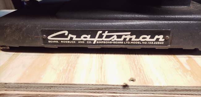

The nameplate was in good shape. I couldn't find a serial number.
