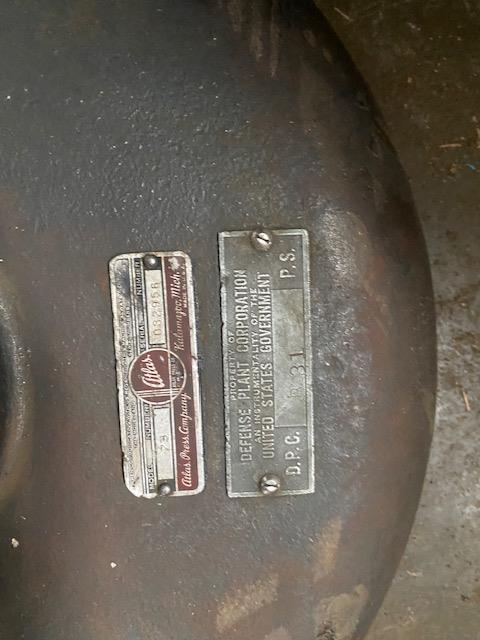

SN and DPC badges
Jay Hoffman

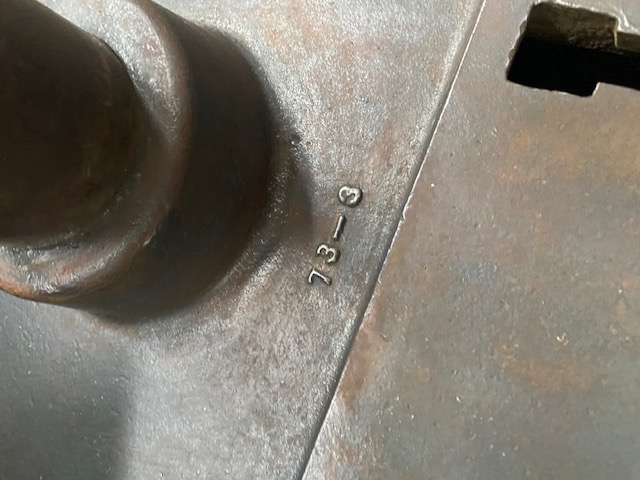

Model Number on Base
Jay Hoffman

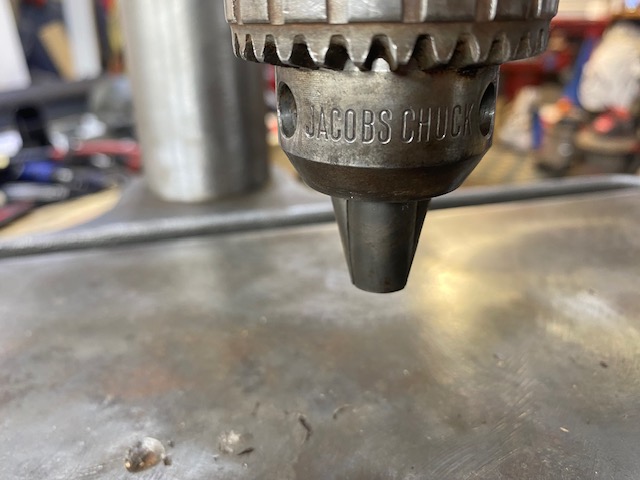

Original Jacobs Chuck?
Jay Hoffman
