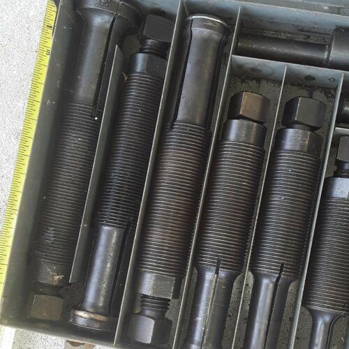

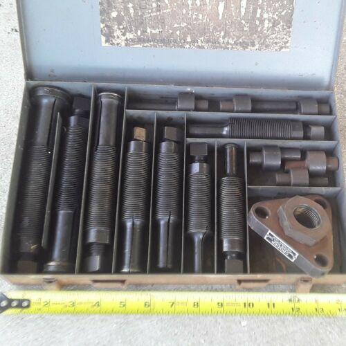

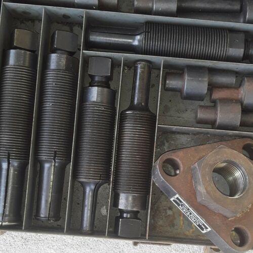

Bushing & Bearing Extractor Set No.86
6/2/2025 6:57:10 PM
Photos from Internet.
Series 86 Extractors

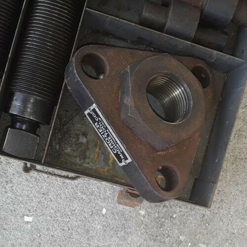

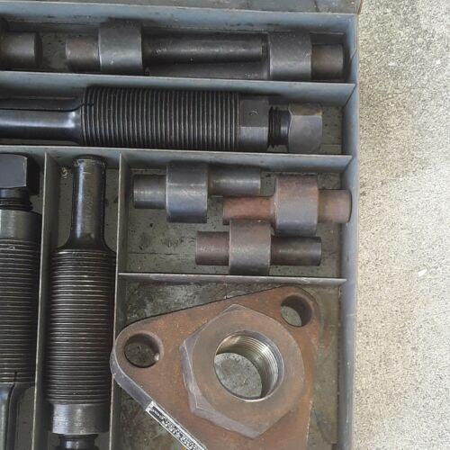

The Series 86 consists of eight standard and three special size threaded arbors, a draw table with a set of short legs and a set of longer legs, a thrust washer and draw nut.
The standard capacity of the set is from 1/2 inch diameter to 2-inch diameter (Arbors #11-A through #11-H). A maximum depth of 2-1/2 inches can be drawn at one setting. Press fits of over five tons have been extracted with the extractor.
