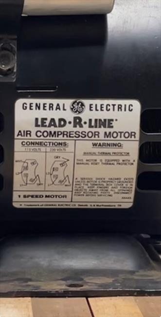

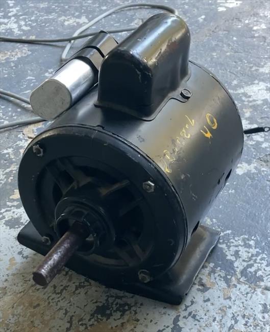

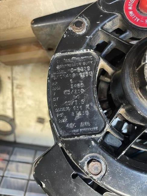

Motor
1 HP
Easton H
"Lead R Line" 5KCR49PR105U
~ 1980
7/10/2025 5:52:26 PM
Bought at an antique store, not working. Replaced the run cap and worked great, then had a bearing issue and got that taken care of. The original owner tried to fix it, they installed a new start cap. Apologies for the bad pictures!
Front
