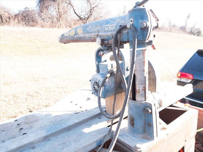

This was in storage for ten plus years and sold at Smitty's sale in Jan. 2020. A 3 hp 3 phase machine, had been originally procured by the air force and had been wired for 440 volts AC. I would strip it down that summer, but wasn't able to put it into service until 2024 after acquiring a single phase GR motor and carriage that fit on the GA arm (with some minor alignment changes, since it was not the same dimensions). I still have the original 3 phase motor and may swap it back at some point, or switch out for a larger motor if I can find a 5 hp that fits the GA arm.

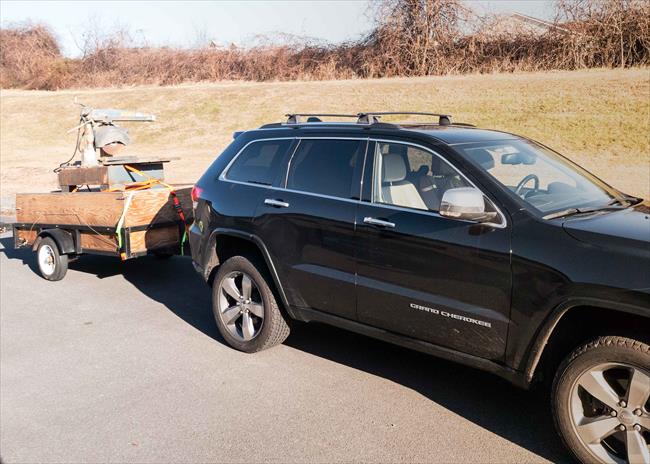

pickup at smitty's sale - Smitty had a forklift to load it on the trailer.
wood block placed under motor to support arm during the trip, about 45 minutes via highways.

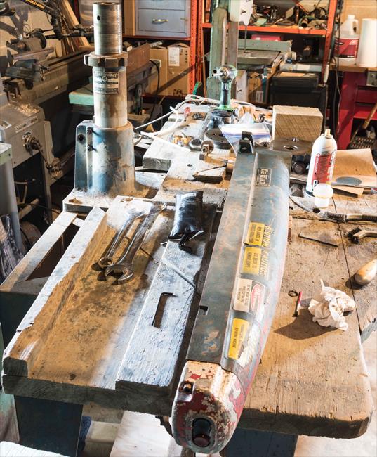

starting the tear down of the GA, stickers and ample coats of blue and red paint.

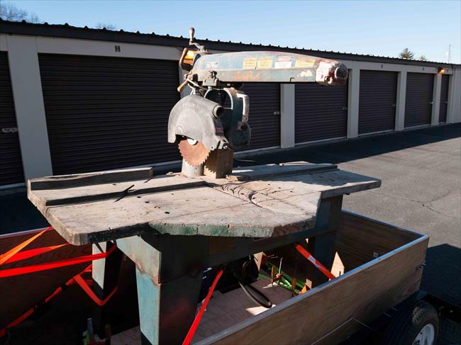

the original table was massive, and had the extension in the middle to cover the full range of travel.

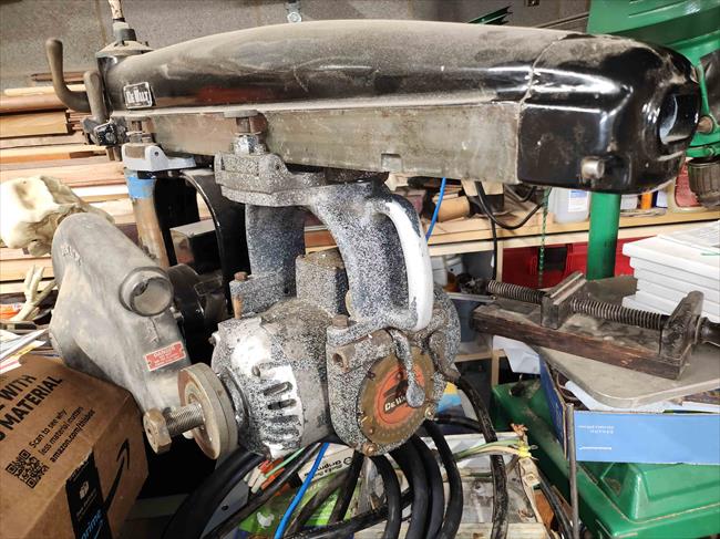

This is the GR single phase motor and carriage test fit to the arm before motor rebuilt and paint.
