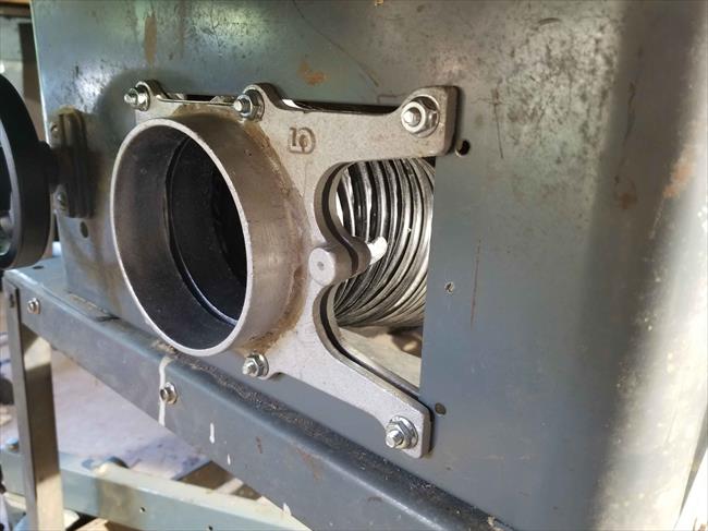

I bought this at an estate sale July 2018. It was my first stationary woodworking tool. It is still the centerpiece of my shop, and I have invested to upgrade it with a better fence, router table, and sharkguard.
I addded this port which was a natural fit for the rectangle cutout in the machine, to feed the dust flex hose to the dust boot.
This is when I began colonizing the garage with stationary power tools. The mobility of the contractors saw was a plus. However, the footprint is nearly the same as a similar vintage cabinet saw, but I didn't know any better at the time.

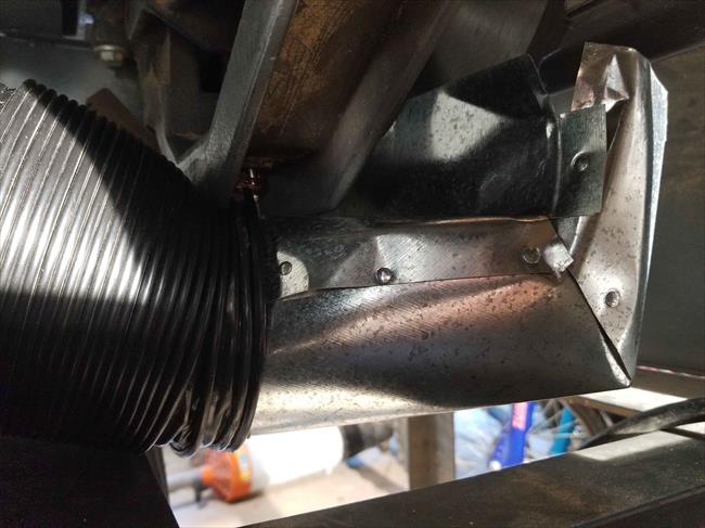

the dust boot is a tight fit, and is a hack job because I can't lower a 10" blade without contacting the sheetmetal of the boot.

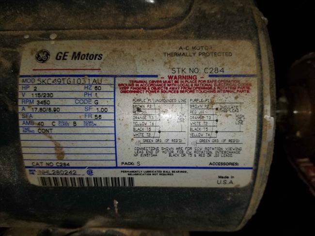

this is the motor I initially put on the table saw because I was running a single 20 amp outlet to the garage at the time. It has plenty of power to rip hardwood.
I eventually upgraded power to the garage and reinstalled the motor that I originally got with the saw, which I switched back to 240 VAC on a dedicated 20 AMP circuit.
