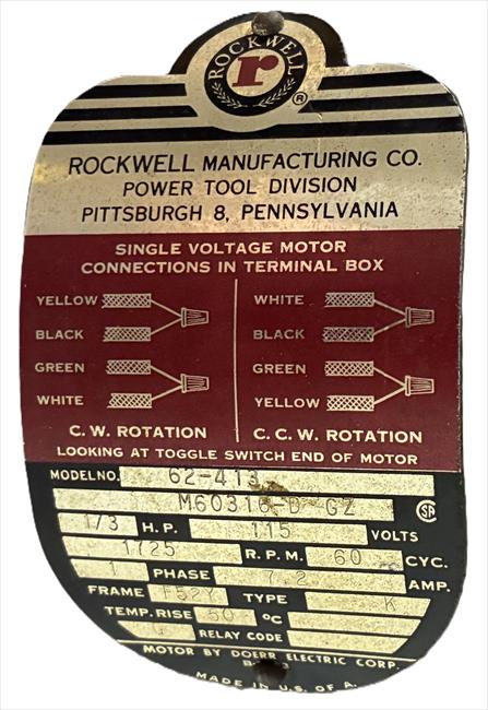

Doerr Electric Corp., Model 62-413
1964 (date of drill press)
M60316-D GZ

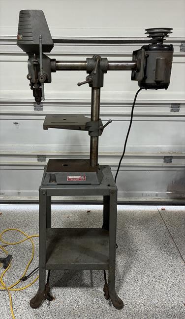

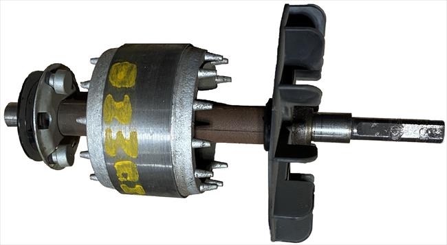

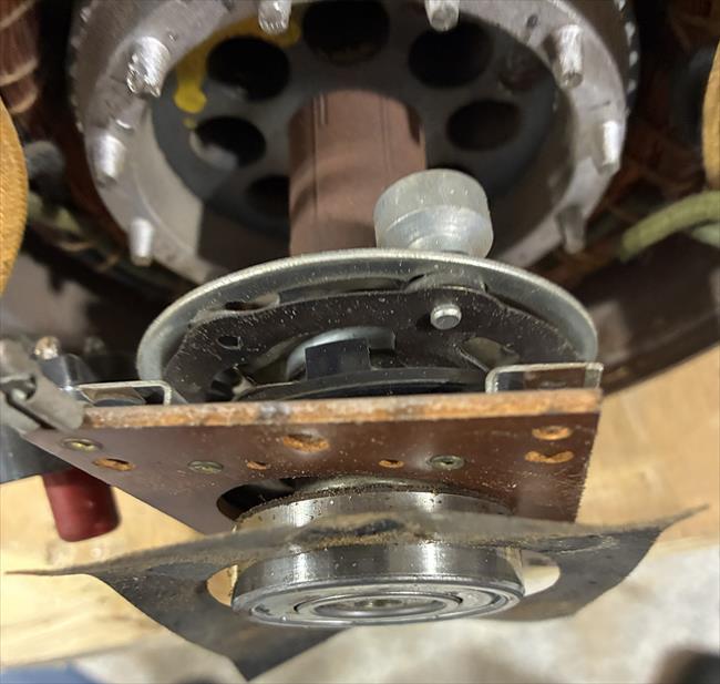

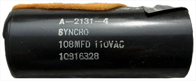

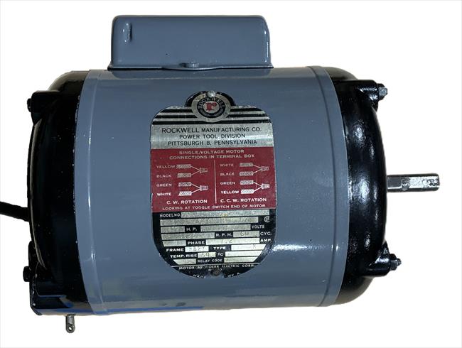

This Doerr Electric Corp. motor is on my Rockwell 11-280 Radial Drill Press. I replaced the bearings (Hoover 77203) with SKF 6203 ZZ. I replaced the capacitor with a TECO SC0005. There was a spring washer on the shaft bell side and a rubber gasket between the centrifugal switch and the bell (Picture 4). Cleaned the rust off the stator and painted with Rustoleum Gloss Black and Gloss Dark Gray spray paint.
As Found on Drill Press

Motor Badge

Original Capacitor

Centrifugal Switch

Armature

Finished Motor
