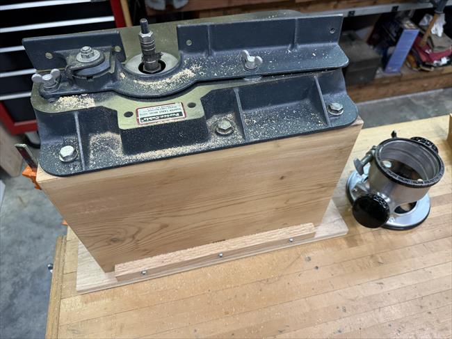

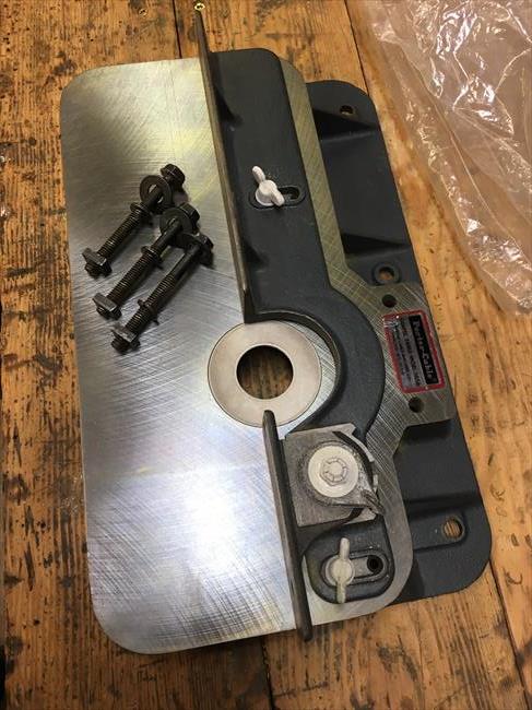

Porter-Cable 5056 shaper table for various routers.
Cast iron table and fence.
Concentric stepped rings for locating router base (without sub-base).
Two L-shaped steel clips with wing screws hold router base.
Steel insert for smaller cutters.
Fence has adjustable infeed for jointing or full edge removal.

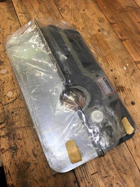

March 2019:
Estate sale find. Appears to be NOS.
Lag screwed to a chunk of 2x10 and clamped in woodworking vise to use.
January 2026: Built stand-alone support to use as a small portable shaper.
iPhone 12 Pro camera-existing light

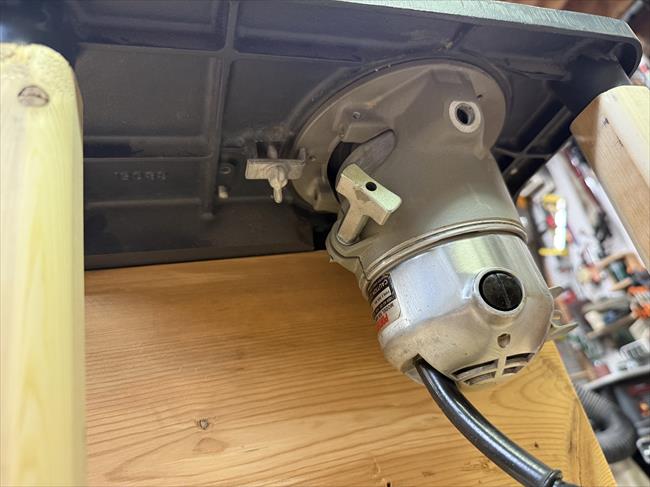

Support: 3/4 plywood base, 2x10 rear, 2x2 uprights with round taper tenon tops and loose dowel bottom ends
iPhone 16 Pro-existing light
PC-100 router

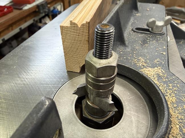

Test cut--Shaper spindle with 5/16 bore cutter
