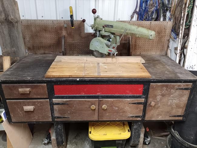

I found this saw on marketplace listed for free. It was a couple of hours from me and I didn’t really need another saw, but I really liked the bench that it was built on. I watched it for about a month before I contacted the seller. He confirmed that he was getting rid of it for free and that the bench had to go too. He was about 2 days from sending it to the scrap heap. I made arrangements with him to pick it up that weekend. The table was crap and the saw had lots of seized parts, but overall not bad, especially for the price. I replaced the brake with a new switch, retired everything, installed a new capacitor and cleaned up the bearings. I had the table from my recently rebuilt GWI that was in pretty good shape so I slapped that on away it went. Now it cuts smooth, quiet and accurate.

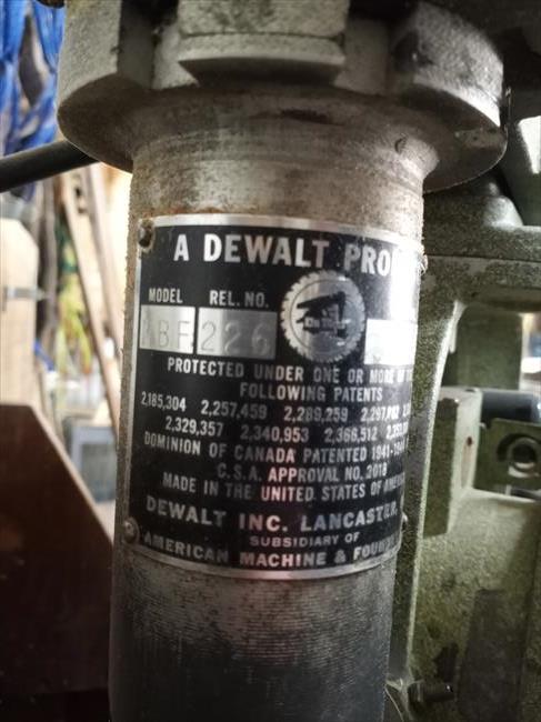

MBF with included bench. Also came with the bench plans and manual.

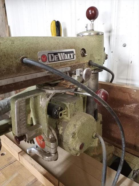

Took off the brake and added new switch and wiring.

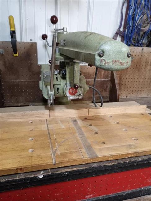

The table came from my GWI. It worked out pretty well.

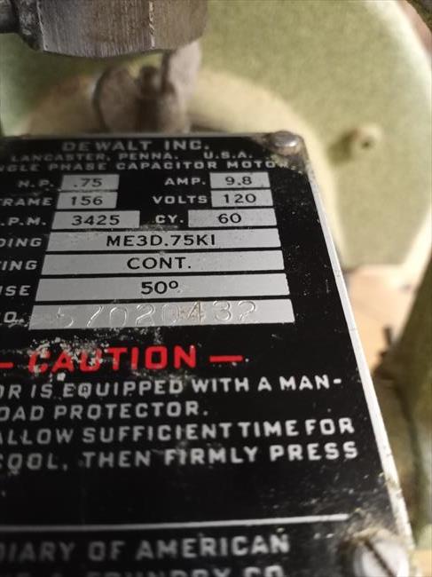

Motor tag showing it to be a 3/4 HP 1957 frame 156.
