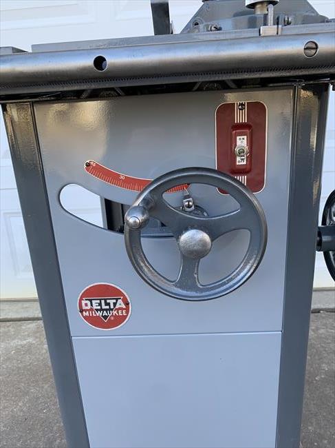

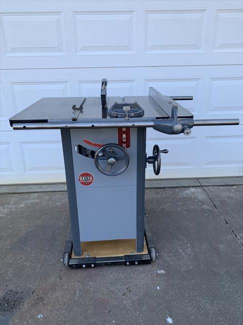

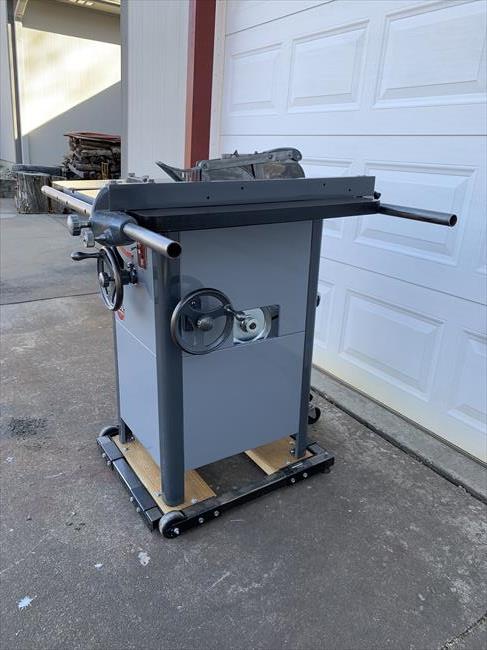

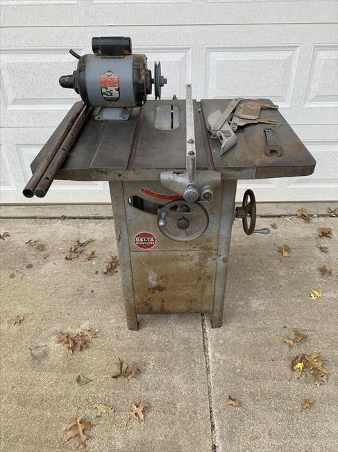

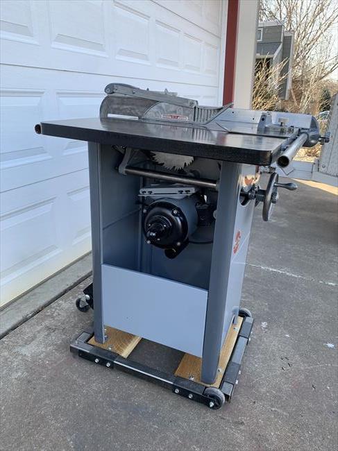

I picked this machine up 3 years ago from another OWWMer in Colorado who wasn’t going to have time to restore it. He only asked what he paid for it - $25. It apparently came from the relative of an older gentleman who had passed. We both found the saw on MarketPlace at the same time. I’m in Kansas and called to see if he would pick it up for me - he was already on the way to get it. According to the back story he got, the saw spent its entire life in a private, home shop. Other than rust on the cabinet, it was in remarkable condition. Serial number is 77-3425 which I believe puts it in 1947. Original motor, throat plate, switch and switch plate, blade guard, arbor wrench, fence w working micro adjust, mitre gauge, the works. The badges you’ll see in the pics are unrestored. I just removed them to have the cabinet sand blasted. I then painted the cabinet and reinstalled them. The remainder of the saw was disassembled, stripped, bearings replaced, de-rusted, new wiring installed, and then painted. I used Rustoleum Smoke Grey (light) and Charcoal Grey (dark) and decided to have some fun with the cabinet corners. I will say - The best way to disassemble one of these is to get it upside down on a workbench, then remove the tilt/elevation wheels and shafts - then you can unbolt the cabinet and remove it.
As found.
