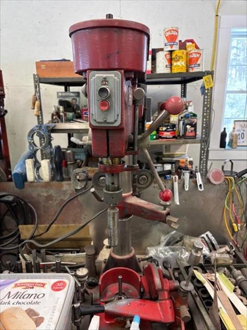

Overall view. The machine is based on a drill press. Not sure what model of drill it is.
Janet Martignetti

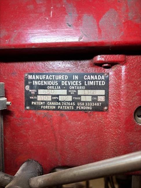

Label #1: Ingenious Devices, patents CA-747,645 and US-3,333,487.
Janet Martignetti

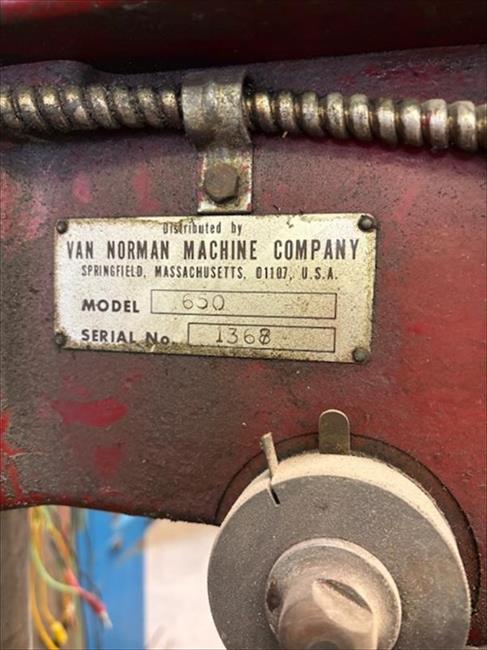

Van Norman label.
Janet Martignetti

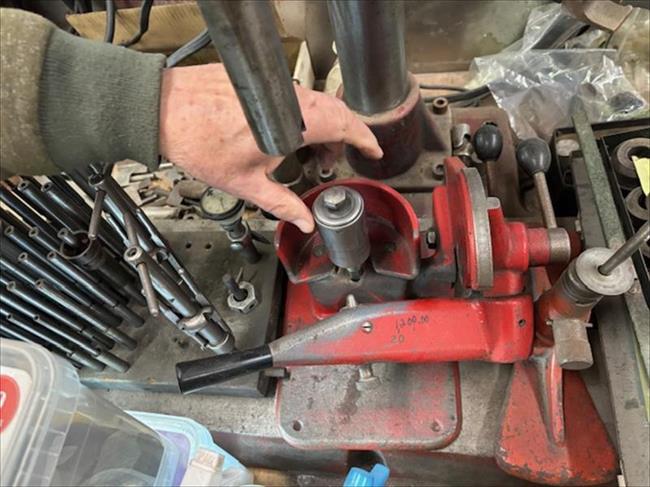

The red bars support the cylinder head on the table of the drill press.
Janet Martignetti

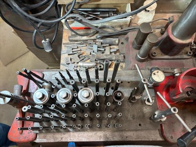

Collection of reamers plus a few bushings . The reamers take the valve guides to exact size.
Janet Martignetti

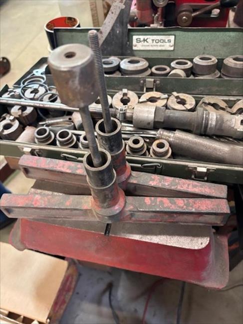

Don't know what this is. May be unrelated.
Janet Martignetti
