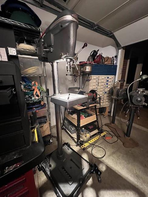

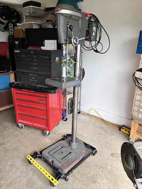

My wife and I made a day trip from home near Memphis TN to Coulterville Illinois to get this drill press. I had been looking for one from this time frame. I was excited to see in the one picture posted that it had a Multi Speed Attachment as well as the adjustable table with no drill holes visible. I could see it had the original motor and the seller sent me a video of it running so we hit the road on a Friday morning. Other than surface rust it looked great. I gave it a good cleaning and de-rusting. It is all original paint with the exception of some gray primer I put on some rust spots on the underside of the foot. I added a new toggle switch and power cord to the motor along with a light fixture, again a design given to me by FrankLee on the Garage Journal. Finally, I added a Harbor Freight mobile base modified welding a 1/4 inch diamond plate steel to the base and bolting the foot to that. This is YouTube short of the build I did on the base. https://youtube.com/shorts/4csDf_bfBmI?si=XFVSUlmtjQdEeeAC. The base also has a single pedal used to engage both front wheels. The base weighs a little over 50 pounds and has a very low center of gravity. I think the rear wheels are off the ground 3/4 of an inch. I got the idea for the foot pedal from an old Rockler video but John McGrath had a better design in my opinion. Here is a link to his video. https://youtu.be/9-YH-EitEgM?si=oSHpZHC71tdNhm1V. Big thank you to Jeff Rich as well for all the great information and instructional videos. If Jeff sees this he will notice I'm wearing Oofos / sandles in my shop. Yep, "My shop. My rules".
The final setup with the mobile base completed. Very solid and not top heavy when moving
My iPhone13
The light just floods the table

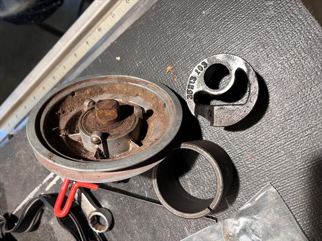

The MSA i in great shape
My iPhone13

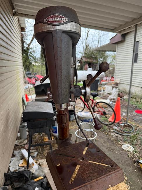

What it looked like when we picked it up.
FB MarketPlace Photo

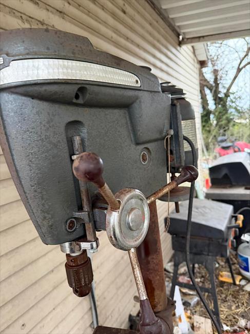

She was rusty but the table had no drill marks.
FB MarketPlace photo
