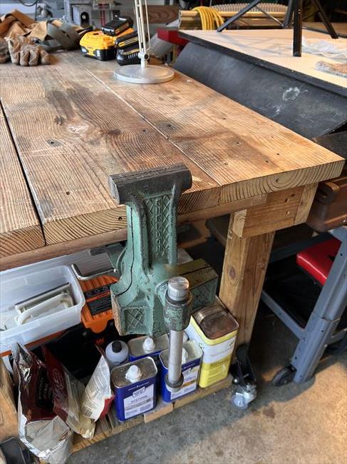

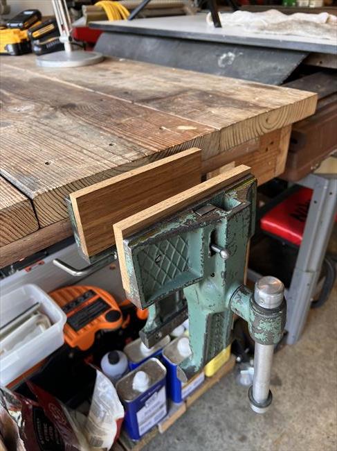

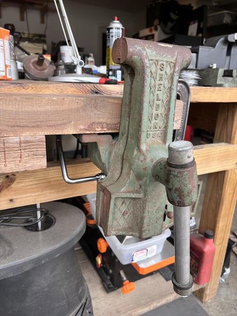

My wife and I won this vise at Arnfest South's raffle 4/11/2026. I don't have the name of the previous owner. It still needs cleaning up at this point and need a turret locking bolt. I made a bolt for it and tested it out. I found a video of the same vise on Youtube and copied that locking bolt. the locking bolt is 8 inches total length bent at 90 degrees at about 3 1/2 inches, with about 1 inch of 3/8 x16 thread. I drilled out a 3/8 inch nut at 25/64th so it would slid over the threads and I could weld it on the rod at about 1 7/8 inches from the bottom of the threads. The vise fully opens up to 7 1/2 inches. Here is a link to the vice after cleaning it up and mounting it to my workbench. https://youtube.com/shorts/aBK89KLTC9c?si=xgGzBPFqrVp6WdK9
Oak jaws installed and level with the bench top.

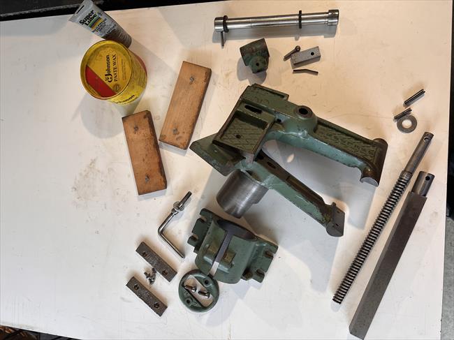

Everything cleaned and ready for assembly

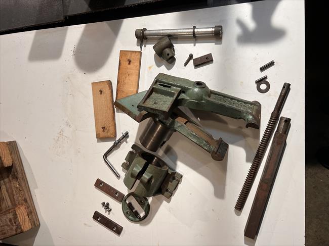

Came apart easily.

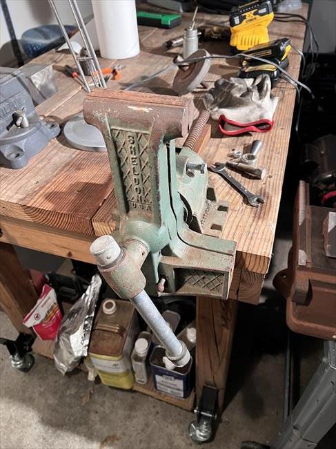

Turret bolt added and tested before clean up.

My new vise from Arnfest South 2026
