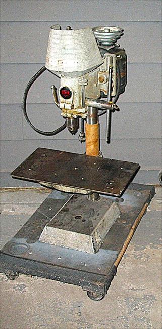

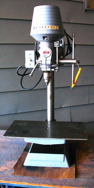

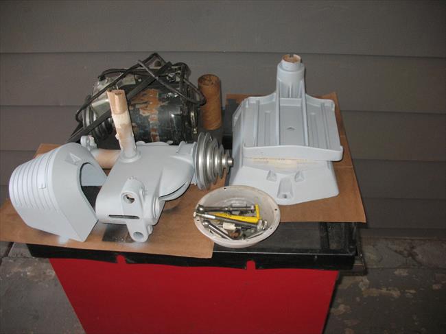

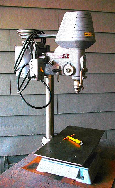

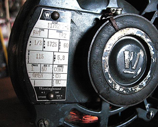

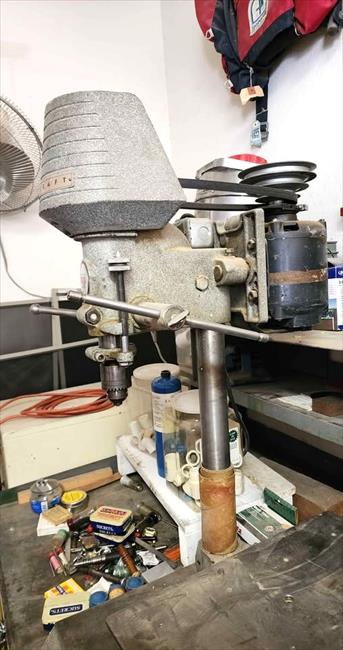

Bought this Drill Press at an Estate Sale, 04-26-2026, without trying it out, as the Electrical Cords were very deteriorated and Unsafe to try. Everything looked complete, but they had added a heavy metal plate, to make a larger drilling table. The Motor is a Westinghouse, 1/3 HP, 1725 rpms, 115 Volts, Phase 1, 5.8 amps. The Drill came with 2 Chuck Keys, one Regular and a longer Yellow one for a better tightening grip. Disassembled the main Machine Parts, clean and Primed them, and repainted them with RUST-OLEUM #7587 DARK MACHINERY GRAY. put on good Electrical cords and Switch, and a 4L-360 motor drive belt, and the Drill Press worked as it should.
Front as Restored

As Found and Bought

Some Parts Primed

Motor Information-Before Restore

As Found and Bought

Restored-Ready for Use
