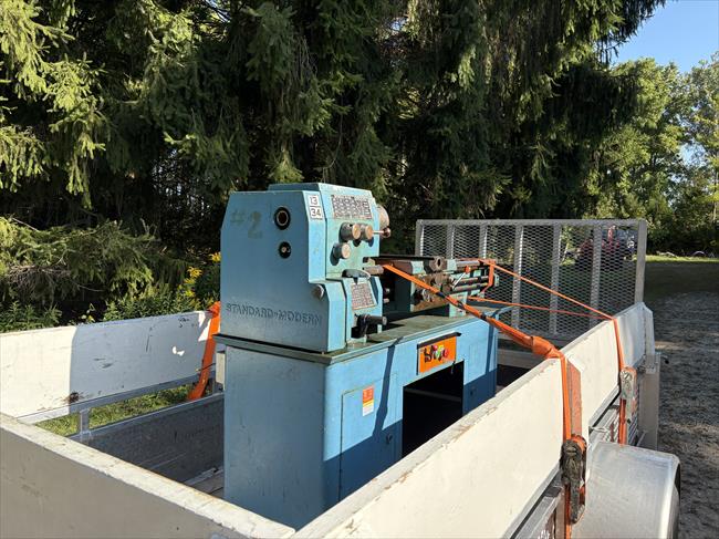

This lathe came out of a Sarnia high school.

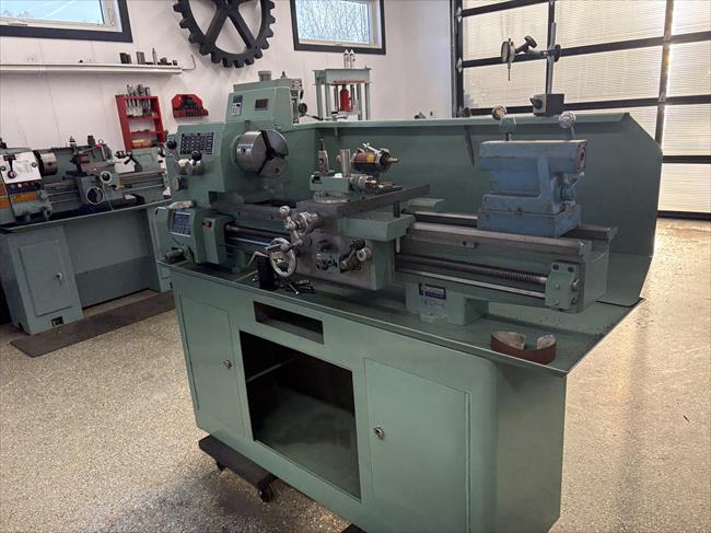

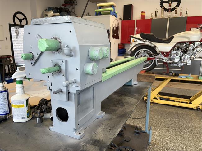

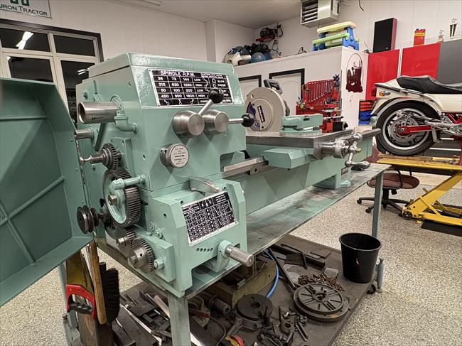

It was in decent shape but needed a good cleaning and checkover.

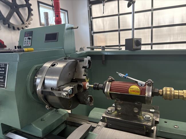

I ground the chuck jaws with 0.001 run out now.

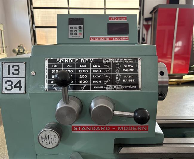

Added a vfd and made a custom control box for rpm display, start swich and vfd control display.
Very happy with this unit in my shop.
