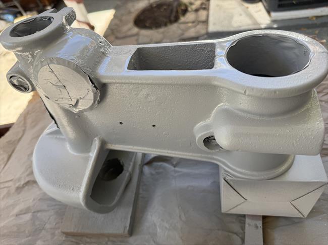

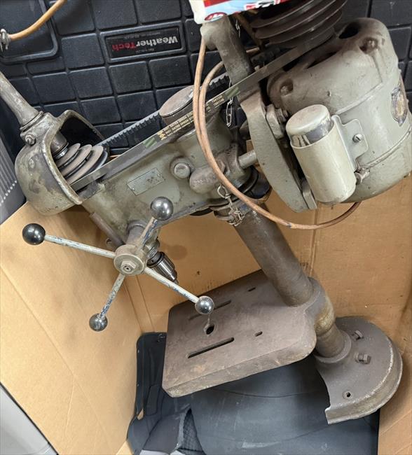

This is a classic Waker Turner 15" bench drill press, purchased in April 2026 from Culver City, CA. The drill is owned by the seller's father-in-law, who I believe is the original owner and has an in-home machine shop. The drill press suffered a sheared-off base when it was dropped during the first buyer's purchase a few days earlier, and they abandoned the purchase. I bought it at a discount and went to eBay to buy a similar part, which later cost me more than the Drill itself. Oh well..

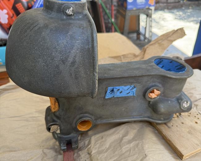

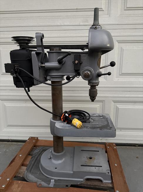

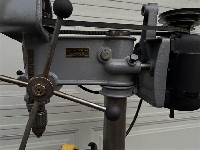

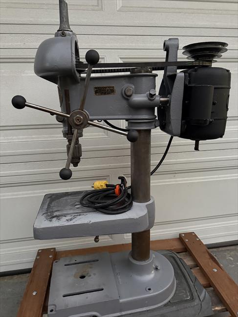

Fast forward, the restoration was straightforward: I removed a couple of layers of paint, which had prevented it from rusting over the years; cleaned off a lot of gunk and dried grease; applied primer and Dark machine gray; and replaced the motor capacitor, which was humming and wouldn't start. Replaced all electrical wiring and the cord. Lubed all the moving parts with new grease; the bearings are fine, so they don't need replacement. I also uncovered a tag from the original store where it was purchased in the 1940's
As purchased conditioned
Bare Cast Iron
Coat of primer and later enamel
a little over sprayed the table top for to prevent rusting
Orignal store metal plate tag
