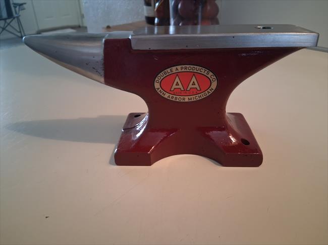

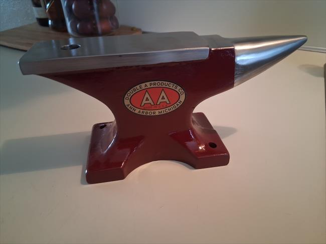

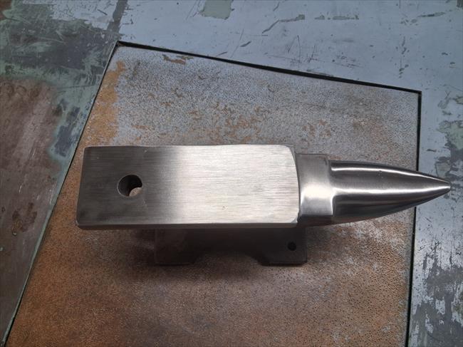

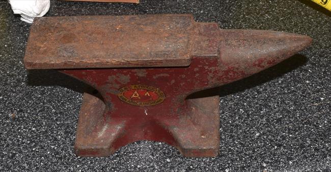

Anvils top was surfaced slightly on a 6" wide blue zirconia 80 grit belt sander flat. The anvil horn was flap disk ground to remove factory imperfections, then smoothed out with 3-M Roloc disks and finished then on an 8" fiber wheel. Old original paint was hand sanded down, this paint was not the normal red AA color seen on their other products but was more of a dark red maroon toned color (see as received picture color) that I matched up close as possible to this darker factory red color. I purchased two new AA Products side reproduction decals off ebay.
Note: this anvils top surface is super hard (R55-60 approx.) and when I was rolling the side edges and Swiss Pattern metal file was just skating off it not cutting much at all. I had to use a 400 grit diamond stone to roll/relieve this anvils side edges.
Restored Side View R
C. Garrett Samsung A-16
Restored Side View L

Condition as purchased
eBay Seller picture
Top Restored view
