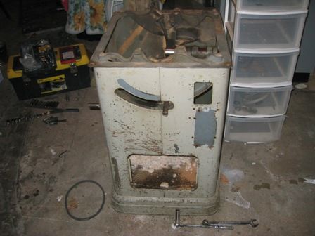

Saw in the first stages of disassembly. Had a rough life on the outside.

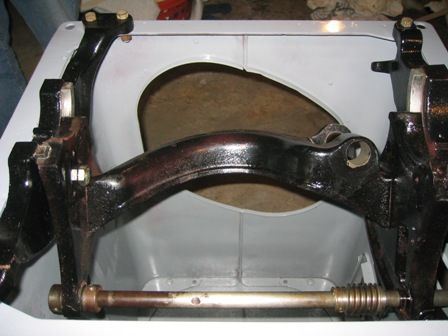

View of the guts after cleaning, painting, and reassembly. Alignment remains to be done.

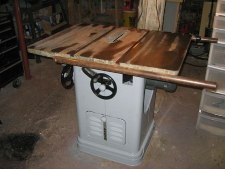

Front of machine with top on. I sprayed top with rust prohibitor, as I had to put the machine away for a while. Rust is very light, will come off with steel wool.
