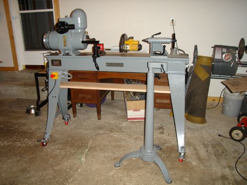

Description/Model: No. 51-B(K) w/"Type II-B" Kimble "Dome Top" single-phase variable speed motor
Date of Manufacturer: 1923
Serial Number: 28349
Last Updated 10/13/2006 12:00:00 AM
This machine was previously posted w/the help of Jeff McVey! I have since restored the lathe and wanted update the entry! According to Jeff, this is the earliest "Type-IIB" (Dome Top) Kimble lathe known thus far, and establishes the start date (1923)for the production of that type, as well as the cut-off (1922) for the earlier "Type II" (Conehead). A local electrician rebuilt all the brushes from scratch..it runs like new..bearing were kept original as they still worked great! Good for another lifetime!
