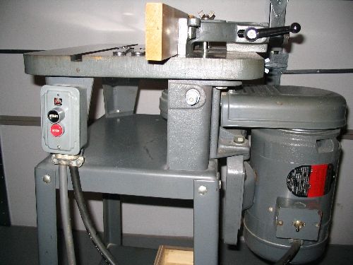

It was well used, but very well looked after. It had no rust on any parts and even the paint job was still excellent. After complete disassembly for cleaning, I decided it was not even worth the time to paint it. It has the original Cutler Hammer switch with art deco cover, which I like a lot. It also came with the original manual and parts list. It also come with a spare tie rod and included all the parts like the wide motor pulley, belt cover, tapered pin, complete fence, etc. Have a look at that long frame motor in the photo below. It is only 1 HP, but it is by far the largest and heaviest motor in my shop. It has a reversing switch right on the motor junction box.
Probably the biggest disadvantage of this shaper is the small work space of the top for handling larger panels. When I was re-assembling the shaper, I was thinking of ways to make an in-feed and out-feed table to increase the working area for handling larger boards and panels. I decided the only way to do it effectively was to build it into a cabinet with work space around it. When a friend was replacing his kitchen counter tops and throwing the old ones away, I grabbed it quickly and decided it was time to build a shaper cabinet. The final product can be seen in the photos below. I cut the shape of the shaper in the counter top to make an extension table. The shaper bolts onto a thick shelf underneath the top. Accurately planed blocks of wood underneath the shaper were used to "shim" it for exactly the same level as the counter top. I still have to adjust the spindle height and lock it all the way underneath the table, but the extra work surface makes up for that small inconvenience. One other disadvantage of the extended table is that a miter gauge cannot be used. I realized that before I built it, but it did not matter to me as I do not use a miter gauge anyway. I use a shop-made sled that slide against the fence.

Condition as I brought it home
