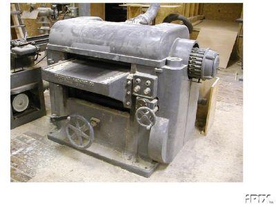

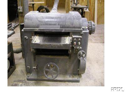

From Ebay. Crescent Brand 24 inch Planer with four-knife round head.
Specifications of P-24 Planer
Length of knives - 24 1/4"
Length of Bed - 52"
Speed of head - 3600 rpm
Cutting circle of head - 4 1/2"
Feeding speeds - 20-60 feet per minute
Power required for feed - 1 HP
Power required for head - 5 or 7 1/2 HP
Will plane maximum thickness of - 8"
Will plane minimum thickness of - 1/8"
Will plane maximum width of - 24"
Shortest piece will plane (butted) - 3 1/2"
Shortest piece will plane (not butted) - 14 1/2"
Net weight - 3100 pounds
cubic measurement - 112 cu. feet
overall height - 45 1/2"
overall floor space - 52" X 59"
Diameter of outlet for dust hood - 6"
