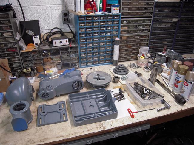

Started disassembly and cleaning process. Scraping off 50+ years of foundry grime with a wooden stick and washing individual parts with Zep in HOT water. It looks like mice took refuge in the belt guard at one time. Seeds and chips got into the head casting (from the upper lift attachment slot) and jambed up the pinnion to quill mesh (mental note--cover this slot unless I find the lift balance mechanism). Found a newer layer of gray paint on top of the putrid green, which covers the original color.
January 2009:
Painting and cleaning complete. Reassembly begins. Finally punched the spindle from the chuck. Chuck is disassembled, cleaned, relubricated and being reassembled. Lightly dressed jaws with small grinding cylindrical grinding wheel in my Atlas drill press.
June 2009:
Completed cleaning and painting the base and column. Waxed column and table surfaces. Assembly complete.

Cleaning and painting nearly complete-reassembly started.
Nikon CoolPix existing light in basement workshop
