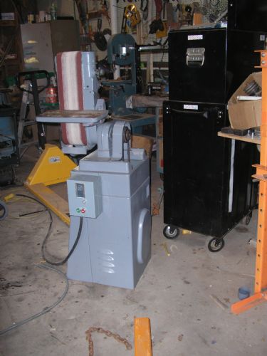

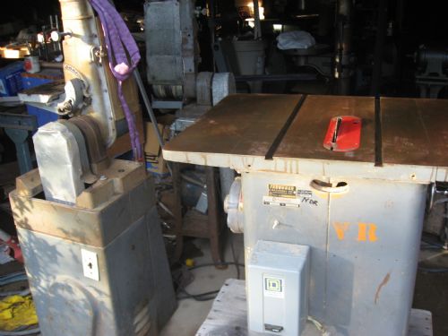

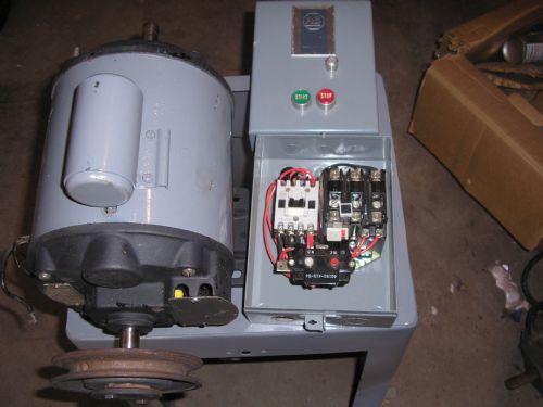

I picked up this sander along with a 1949 model for 75.00 on ebay. The seller could not get it to track so he give up on them. I was hoping to get both sanders restored but the 49 was in terrible shape. I stripped, primed and repainted, replaced all the bearings, and installed an old 1 hp Westinghouse Motor. The steel platen was flat and looked in good shape. I installed a 6" strip of graphite canvas during the rebuild. A AB magnetic starter was also installed. It's missing the Disc sander and I hope to find one to make it complete. It now tracks well and runs smooth but the steel stand is not the quietest thing.
Here the sander
The sander before the rebuild, It's setting next to the Unisaw
motor and starter used
