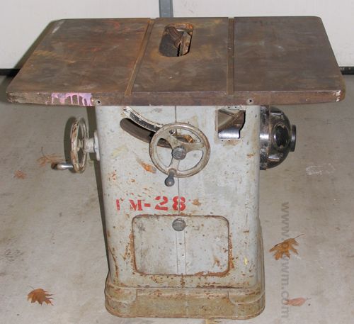

I wasn't looking for a Unisaw long when I came across this one. It actually looked worse than the photos appear, but under repeated slathering of brush paint, it had all its original parts including switch plate, knobs, \dust door, and bullet motor. I also couldn't find anything broken on it. That and the serial number convinced me to buy it with a jetlock fence and an unrelated Delta motor for $350. Some folks may remember my similarly ugly 20" band saw which turned out to be a rough diamond, this was too. The biggest obstacle to restoration was the cabinet, which was repaired by welding in new metal and filling holes. It also got new bearings and wiring, new paint, and the cast iron cleneaed up. I'll add an 'after' picture soon.
Comments: Unisaw - why did someone take a saw to the switch opening?
Source: my photo
Comments: More sawzall artistry
Source: my photo
