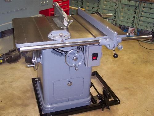

Well its done
Got this unisaw from the school where i work for $40.00. Was 3 ph but motor was burned
out. Also the arbor bracket was broke in two.It had about 30 holes drilled in the cabinet and was in really bad shape. Tore apart and blasted the cabinet welded the holes up.

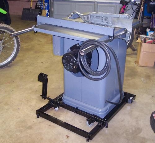

Cleaned everything and put it back together with a new 1 ph 3 hp Leeson motor.

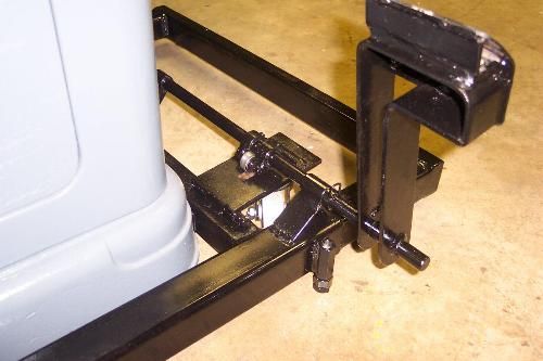

Also changed the motor starter with a square d I had around my garage. The mobile base is of my own design. Made from 2 inch 3/16 tubing with steel casters.The lift works from the pedal with a bearing design. The right side will extend out if i ever decide to put on a
longer fence. It lifts it with incredible ease. If anyone knows the year of this saw please let me know. The Serial # is 112-1177.
