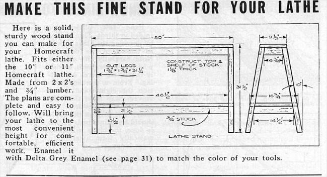

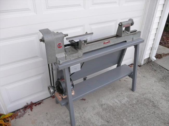

Delta/Milwaukee Homecraft gap bed lathe, 14" over the gap, 11" over the bed. Manufactured in Tupelo, MS in 1959. Picked this lathe up off of Craigslist. Not much to this one, the original paint was in excelent condition so I just did a scrub down with simple green to remove the grime, new bearings, wiring and a new base completed it. The base was made from plans I found in a 1948 Delta Homecraft catalog.
